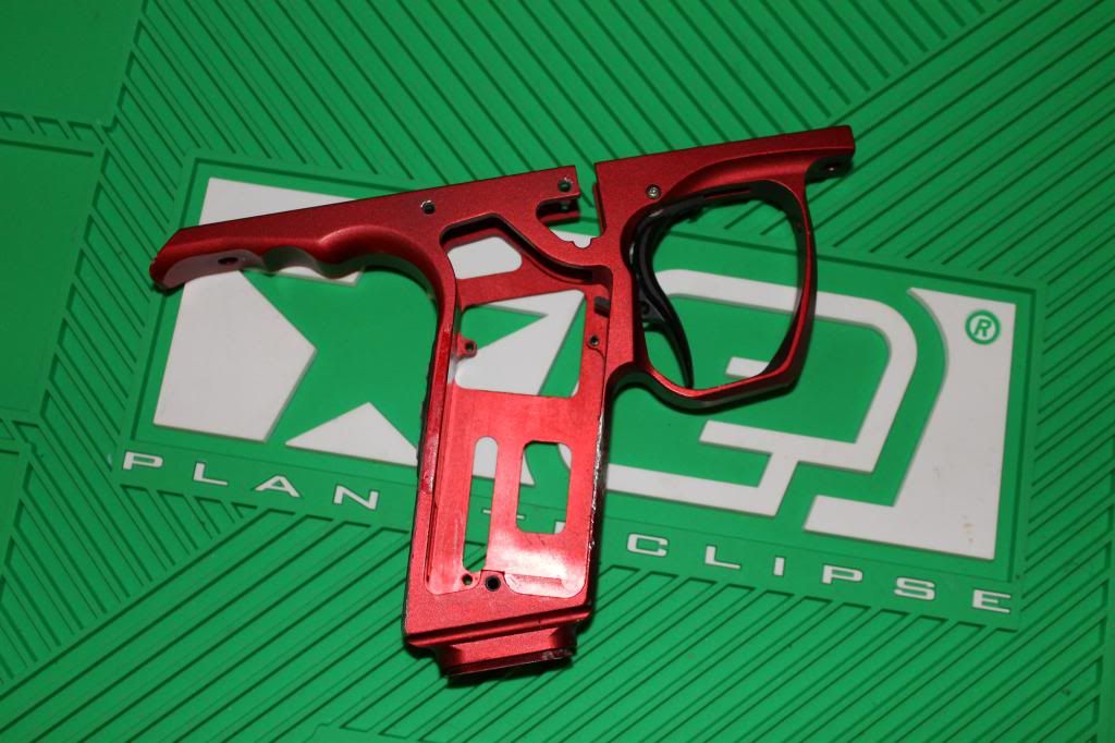

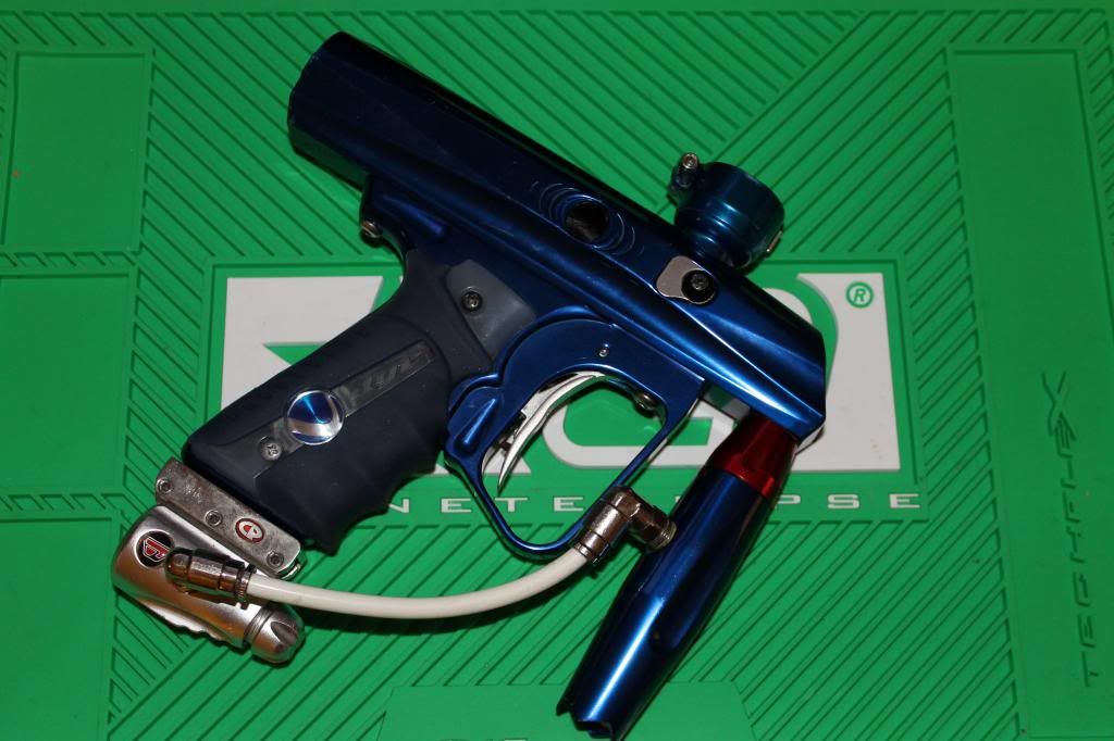

08/29/13 So, i was going through my bin of broken guns and random parts, when I happend to see my beatup stock frame from my EGO6, laying upon a broken SFT shocker... Lets build a Shego!
Backstory: I bougt my EGO6 broken from a dude with Claws. No, Seriously. Dude has no hands. He has pincher claws, that he used o wrap around the frame, and then tap the trigger with the other claw...wild to see, but anyways, I bought a Starframe in th B/S/T, and sent the ego off to CS900 to be rebuilt.
The shocker I purchased as a parts gun in about 2008. Blown upper board, no reg, etc. stumbled across some matching parts, so here it is.
What I would like to do:
-Have SFT Milled for EGO eyes
-Have frame milled to accept Humphrey Noid
-Have frame milled to Attach to SFT Body
-Have Rail Milled off of Frame
-A slick anno job
What I have:
-SFT Shocker w/ Internals and Humphrey noid
-EGO6 Frame
-a Give um hell attitude
What I need:
- a Machinist that isnt going to give me prison sex, and then make me pay for it
- A Annodizer that isn't going to give me Prison sex, and then make me pay for it
-a Ego5/6 Board
-Ego Eyes
-NXT VA
-Ideas for a Slick anno job
-Ego 5/6 Grips
Anybody with leads on any of my needs, PM me, anything else post here

Details of the frame damage:

Now that I see the pics (photobucket is blocked at work), the frame should just be anodizing to take that out. Sand it down some and put a dust anodizing on it and it will be hard to tell that it was there. I did this with an SFT that the previous owner dremeled to polish out parts of the body because they were too lazy to buff it. had gouges all over the body. I sanded it down to where the gouges were minimal and after a dust anodizing you could hardly tell they were there. Was the old G.I. Joe theme one here.

My ShEGO project!
