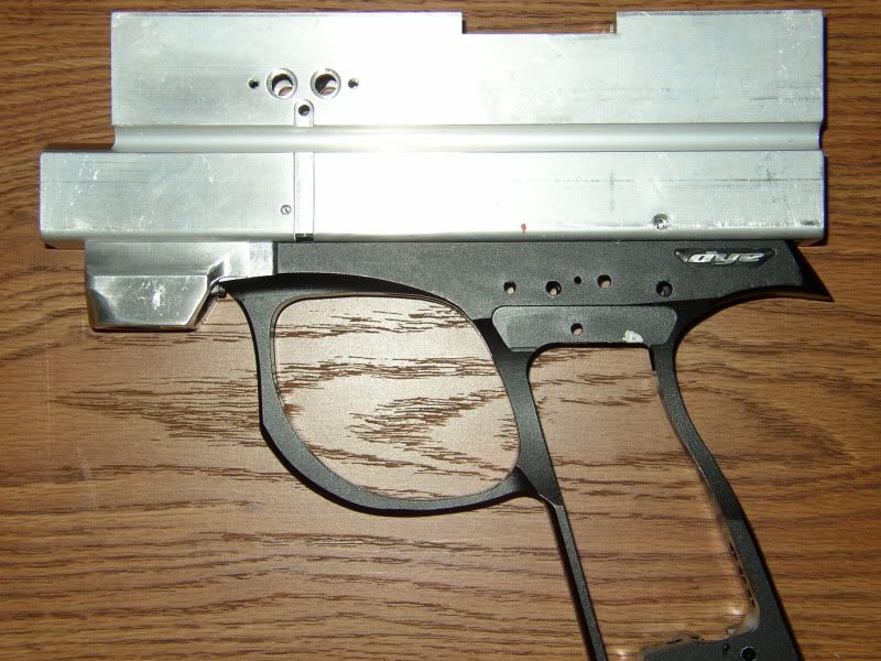

Frame, tray, spyder body and 2k2 ram sleeve at the machinist
body ready to receive parts
bought a set of AKA eyes with an adapter for ego boards from destructive customs, which should make me stop worrying about soldering eyes to the board
LPR swapped for a volly'd verdikt
spyder body will be blast hole modded
the sleeve will have the rear barb port bored out to 10-32 the front will remain 3M for now, the transfer hole on the sleeve will also be bored out
the prototype spimmy will be blind, if the mods prove successful they will carry on to the end marker.

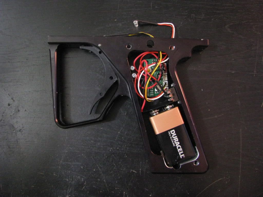

Can't believe it's been 3 years since I started on this, but it's finally done.
I present to you my Lasoya timmy build:
This thing has every mod I could come up with, I'll dial the regs in as soon as I have some paint, but in the end I expect it to work at about 200/65 PSI and get almost a case off a 68/4500 with a decent underbore, the .682" kaner (which is actually .680") should help with this, and be as smooth as my FEP quest.
Parts description (top to bottom & front to back):
  • Empire 2k2 feedneck
  • WGP Kaner barrel " .682" " bore (bores out at .680")
  • Scenario dreams blue laser eyes with spacers
  • ANS venturi bolt with bored out air passage to the same diameter as body air transfer hole
  • Blast hole mod
  • Gen3 LPR
  • Gen3 micro volly
  • Evil front block, drilled for alias set screw and tapped for 10/32 barbs
  • 3/32" ID barb on front block to 'noid port
  • Empire poppet with gen5 cup seal, mechanical dwell shortened to 2.7mm
  • Alias ram sleeve, barb ports tapped for 10-32 barbs
  • Belsales swivel QEV on front barb port
  • Lurker eigenram/spring
  • CP gen3 adjustable ramcap
  • 3/32" ID barb on rear port
  • Crankwalk m3 barbs on 'noid
  • Mac43 'noid
  • Azodin rock steady reg (mostly for aesthetics)
  • 2k5 frame
  • Alias trigger guard
  • Modded gen 4 trigger
  • UTB with 2200uF capacitor and original 2k2 board on/off switch
  • Olive Invert .45 grips
  • Empire mini rail
  • Dye airport non on/off ASA
  • Pure energy tank with LP shim-stack, output @ 300 PSI
All lubed with formula 44D per The Incubus mix instructions.
Quite the departure from the original intent, but then again aren't most projects?

Yeah, I realize it took a turn towards voided warranty rather than a completely custom marker. The machinist I sent the parts to messed up the frame and tray, so that kind of sent me this way and I had to scrap the SMC solenoid and manifold idea (though I'll pick it up again if I have enough money left after buying homebrew kegs, possibly making an updated version of this with custom machined body and frame and a DM6+ 'noid or a quest based spool, don't know yet). Got the lasoya body a couple of years ago (pic in the 2nd to last update, dated 2011).
The original body became a modded blind spimmy, being the test bed for a few of the mods in this thing; including 3/32" ID barbs, QEV in the front sleeve port, gen5 cup seal on an empire poppet shaft, Juit modded evil punch ram, blast hole mod, drilling & tapping the front block for 3/32" ID barbs, just to name a few.
Original body during testing stages:
It currently has a 2k5 front block and a 2k2 LED frame, still waiting for a 'noid and T-board.
