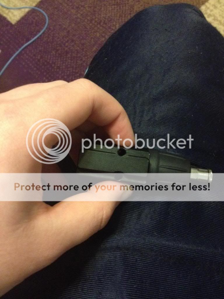

So recently, ANS had a deal of the day sale on a Dye Standard Drop Forward. for $5, I said why not?
I don't feel surprised that it didn't come with mounting screws, but aside from that, it's not even close to fitting my Etek 4 LT.
So my question is: what can I buy to mount the drop forward? Or is it not worth trying because there just isn't any sort of compatibility? I couldn't find any reasonable information online and every retailer doesn't even say anything other than "high grade material" and what not, so I figured I'd try here

Originally Posted by theVicious1 View Post
How does it not fit? The rail won't slide INTO the grip frames rail system, it should sit flush against it from below. Then you screw it in to the two screw holes.
It simply just doesn't work. The rail is flush with the bottom of the grip frame (though I still need screws to keep it in place) but I cannot see how the ASA will mount on the other end of it.
These pics aren't the best quality but hopefully enough to show you what I mean.

The asa wont mount because it is a t-rail, something particular to eclipse markers. You will need a new asa if you want to use the rail.
Are there no screw holes at all in the bottom of the LT frame?
do you think the POPS ASA that PE offers is also T-Rail? Otherwise I'm not really about buying a new ASA regardless but I'll see what I can do. Also, know where I can buy some mounting screws for the Drop Forward?
& unfortunately, the LT frame doesn't have screws or anything of the sort on the bottom :/ the stock ASA mounts with screws but they're a LOT smaller than the screws needed for the drop, and they don't screw INTO the frame at all, but just seal the ASA on it.

I had to custom drill mine to mount a drop. PE uses the dumb T rail system for no other reason than it forces players to buy ASAs from them. The problem you will have is even if you wanted to do what I did, you will need an AM frame. I had to create an aluminum shim to slide into the T slot, then drill and tap through it, into the frame to get a standard 2 hole setup to mount. The good news is I can always go back to the T mount if I want to since it did not effect that. You cant do this with a LT frame as you can not thread into the plastic and I would not trust the shim alone to hold the tank onto the frame.

Yes, both the pops and oops asa that PE offers come with a t-rail compatible mini-drop.
