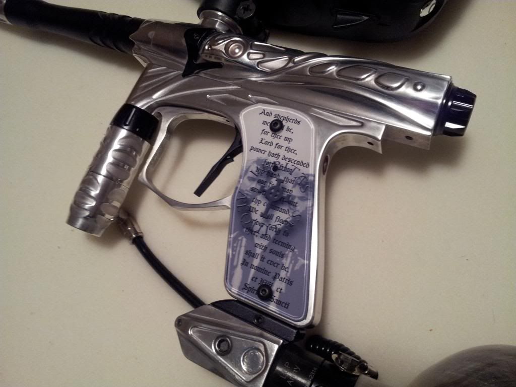

Here is mine. Don't judge the feedneck I lost the collar some where around the house so I had to jerry rig one temporarily[IMG][/IMG]

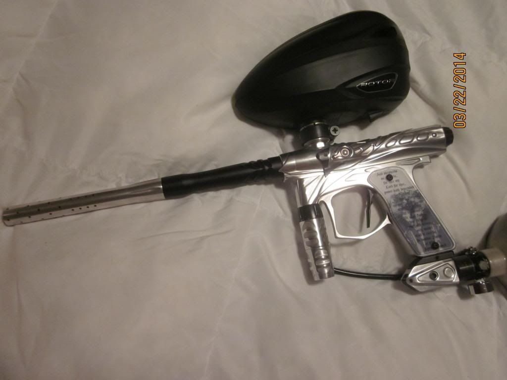

[IMG][/IMG]

Looks stock, but it's not!

Whats under the hood?

Freak bored barrel, APE board, CA Tectonics modified trigger (bearings and magnets), and a TechT engine (awaiting the DW and Yoda engine )

who did the freak bore on it?

A guy that goes by Super Stanchy in these forums and on Facebook.
