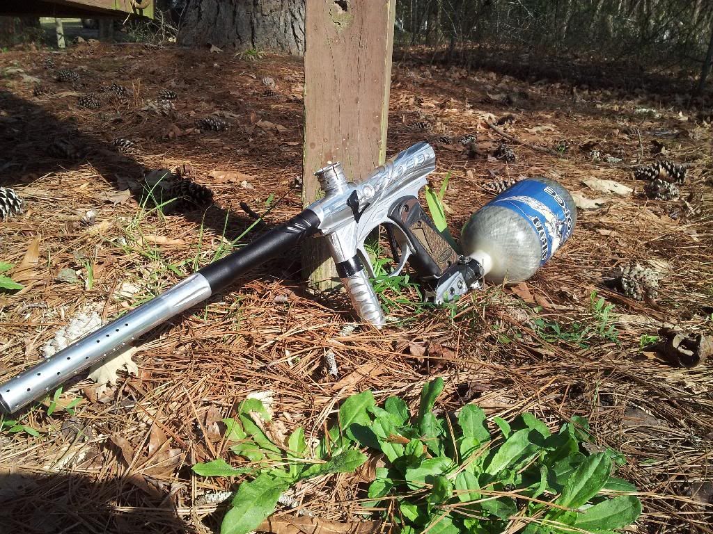

Thanks guys I'm doing it right now here's my progress on getting off the anno and polish, I'm almost done.
[IMG]http:// [/IMG]

looking shiny

nice work! going to anodize or keep it raw?

I want to learn to anodize eventually but I really think once I get all the nooks and crannys on this threshold that it will bring out the extensive and intricate milling that they put into this beast. The poop brown it was before may be for some but its not for me lol. Besides I have a Full techt HE bolt and tooless back cap as well as a new board on the way so Im pretty excited to beef this beauty up. It si the same internally as a REV I and the REV I is a good gun.

Thanks for the info the more the better for me. I have posted a piture ^ there on the progress so far. Its a real challenge considering that the gun is not straight lines like most.
