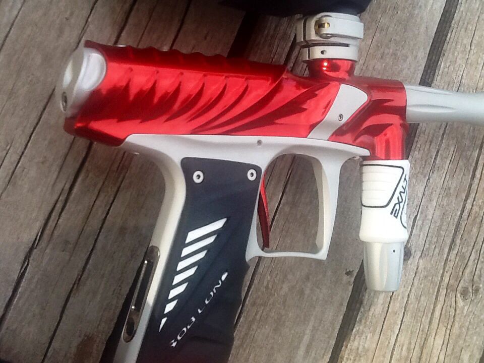

Added a white Exalt reg grip to my Insight, feels nice and looks good.
