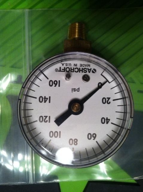

Anyone have problems with their tester leaking? I just got one and it leaks bad. If I apply pressure from the top it stops, do I need to swap out the top and bottom 06 rings for 07's?

I have found 60 to 62 psi seems to work best for me when using my VIS engines. Vcom engines seem to have a broader range of 55 to 65, so I normally set my LPR to 60 or so and don't touch it when swapping engines. PM me your address on the X7OG and I'll send you an updated LPR gauge, I already have tow nice vic pressure testers, I don't have a need for this other gauge.
Here is what you need:
I would just start by lubing and swapping the 06s with other 06s ... I guess it is possible you would need to use a 7, but I have not seen that before on a tester, just Vcom engines.
Yeah I put in new 06's and lubed it with 55 to help them swell, still leaks. I don't have any 07's so I'll have to source those.
I'll pick up that ashcroft gauge from you if still available.

I had the same problem with the tester, after replacing the 06 to 07, it stopped the leak on the tester.

Call blast for a oring kit. I got my ashcroft gauges at Mcmaster-carr
