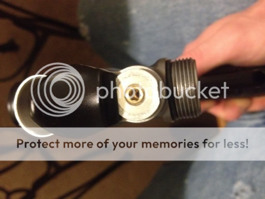

Originally Posted by Bill View Post
The LPR body is turning within the gun body? You need to install the FRM/ LPR screw. It screws in where the HPR threads into the body. It holds the LPR components in place.
Still spins, but shoots beautifully. No idea what screw you are talking about or where it could possibly go:

Old 11-19-2013, 09:34 AM #90
98Pro
Asylum 502
98Pro's Avatar
98Pro plays in the PSP
98Pro owns a Planet Eclipse Ego
98Pro owns a Planet Eclipse Lv1
98Pro plays in the APPA D4 division
Your adjustment screw is out too far take a wrench or pliers to hold the LPR body on the flats and break it loose and then turn it in 1.5 turns. That gun is going to shoot like a cannon with your LPR that high.

Old 11-19-2013, 11:55 AM #91
rossman901
rossman901's Avatar
Join Date: Sep 2012
Location: Cordova, TN
rossman901 owns a Planet Eclipse Lv1
I've fixed it since then. Had just put it back in for pictures of the lack of a screw or screw hole in the body. I had just cleaned the LPR. Thanks for the advice though!
