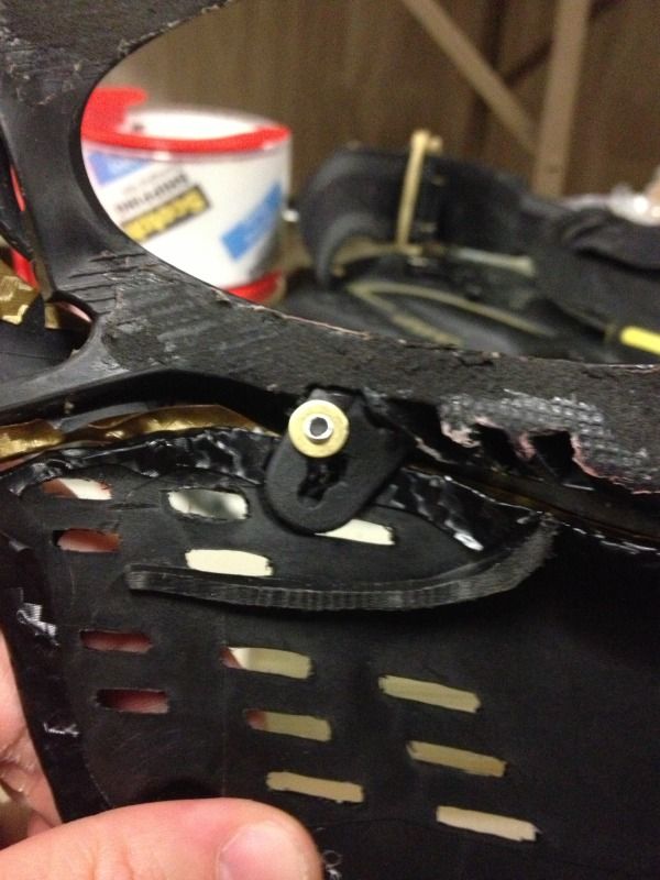

just throwing out an option for securing the bottoms, what about like car interior plastic push pins
Kyle_Cline is offline   Reply With Quote
Old 07-30-2013, 10:04 PM #37
digital sol
Location: Stl
digital sol supports DLX Technology
Thanks, I thought about it but wanted something more secure, those are pretty easy to break/crack. I ended up using the following
Arrow Rivets - Aluminum - Diam: 1/8th (3mm) long - Grip 1/2 (12mm)
Washers: #6s
They are cheap, and the washers fit these rivets perfectly. Used 1 per side and 2 in the middle. Bottoms are not going anywhere with these method.
Inside pics to show where the rivets get installed, its picture perfect with these bottoms as you can use the plastic clips from the factory bottoms to keep the washer snug. And yes, waiting on my new foam to arrive, along with some new lens
