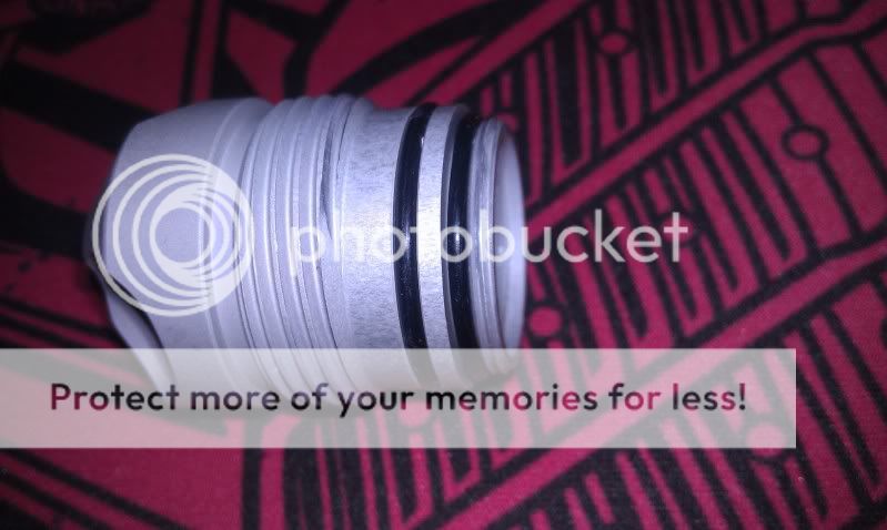

Originally Posted by mightykc23 View Post
i actually tried pulling the core out and everything was left inside, that was pretty annoying.
have you experienced any fsdo?
To solve that I put an oring at the end of the threading and don't lube it. It helps eliminate the engine unthreading in the body.
Two weekends ago in the snow. But one shot fixed it completely. So I would just take a shot before the breakoit
Pics of the Oring and placement?

Yup

Originally Posted by bcrguy View Post
Pulled mine apart and found an oring that fits too. works well.
Primo Add me to the list I'll get pics soon as I have 5 minutes to spare on a non rainy day
Morning all
Nice tip! I have to try that out
In the east coast, snow yesterday and close to 50 today. Sadly can't play cuz of a prior commitment.
