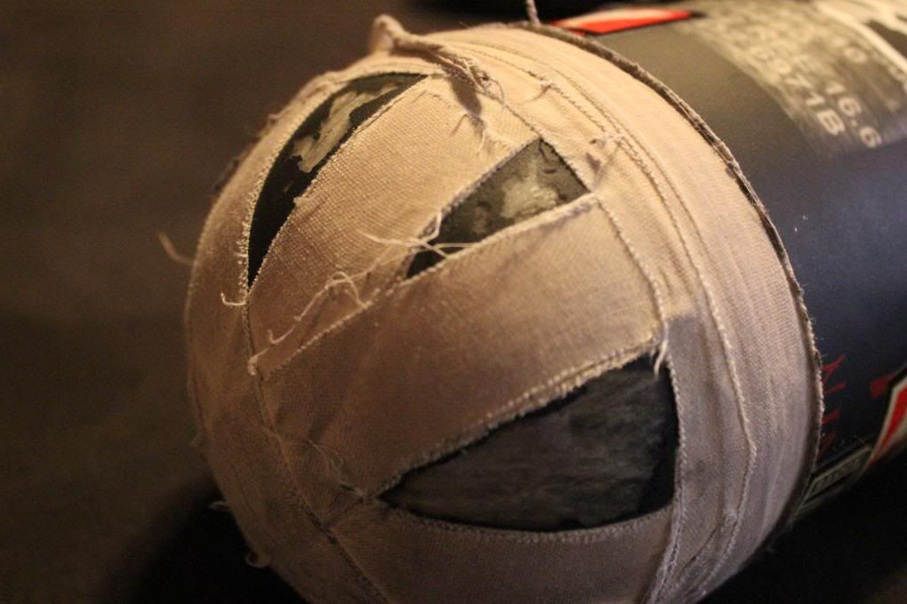

Ninja dura coating peeling
Has this happened to anybody else? Is this just a defect first run type deal?

You can see the fibers! Hababa! I wouldn't use it!

Contact Ninja about this. They may replace the tank, or have an explanation about what is going on. Either way, it may have something to do with the grip tape that you have on the back end of the tank.
Totally untrue. That's the clear coating showing.
I'm leaning towards the possibility of the grip tape being an issue as well. Did you remove and reapply the tape? Perhaps it's the adhesive adversely reacting with the dura coat.

I wonder if its one of the ones from the first batch. If it has a hydro of 10/12 or 11/12, there's a possibility that you received a bottle with a really light coating. We had a few issues about this come up and when we contacted the manufacturer, they said they did rush the first batch and some of the bottles have a lighter coating than what should be on their. You can get it sent in for free through the warranty process if you want. It will come back looking brand new.

Sounds good Rob. It's fine with me as long as there are no issues later down the road. the hydro is 11/12

It was a manufacturers defect. They admitted to it, Ninja is addressing the issue on behalf of their manufacturer.

I've been having the same issue. I just sent the tank back yesterday. Though, from my perspective, the reason my tank was peeling wasnt necessarily because of rough use or play, the biggest peeling it had was from around the part of the tank that faces me chin/face, as if the rubbing against my VForce Grill was causing the peeling... I could "rub off" the coating with just my finger tips. And I have no evidence to back the following statement, but it looked or felt like paint residue from paintballs caused the Dura coat to become soft. Mind you the paint at my local field is GI (Ecofill)
