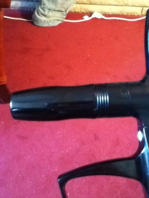

Unscrew lower section of reg.

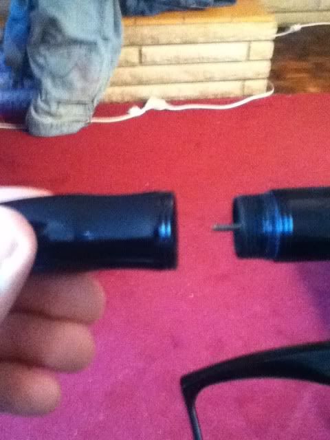

Remove reg section denote valve. (brass thing sticking out of top part of reg)
3.
Take needle nose pliers and loosen the valve, then unscrew it by hand to prevent damage.

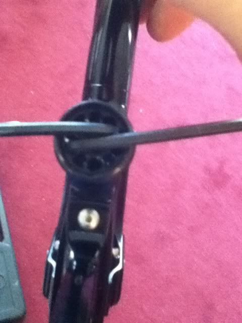

Insert two allen wrenches like so, I used 1/5th sized wrenches that are long for added torque which is needed. It takes a lot of force to loosen this at least with mine it did so be careful.

There's nothing inside at all just an oring I just did it to get it anodized as stated in my first post.

before you try to unscrew it, heat it up with a hair dryer, it helps sooooo much

Or hit it with a Torch back and forth until the Loctite is softened up enough. This will allow you to turn it out with ease using a small Rubber Strap Wrench or your hand if you can stand a little heat.
And yes, this is perfectly safe and will not damage a thing. This is precisely how BLAST Removes Feedneck Bases from Alias Bodies.

I egg shaped the inside of two of the ports doing this. I did get it off I did add some heat from a hair dryer, but I dont really think it is going to hurt the gun at all. Just a heads up for anyone else doing this. I also would like to say it isn't the guy's fault that posted this info!!!

Got mine off the same way and it was super tight stock. I guess that's a lot more convenient then it always loosening. Thanks!

This was so much faster and better that a $50 tool....and it didnt damage it in any way.... just came right off
