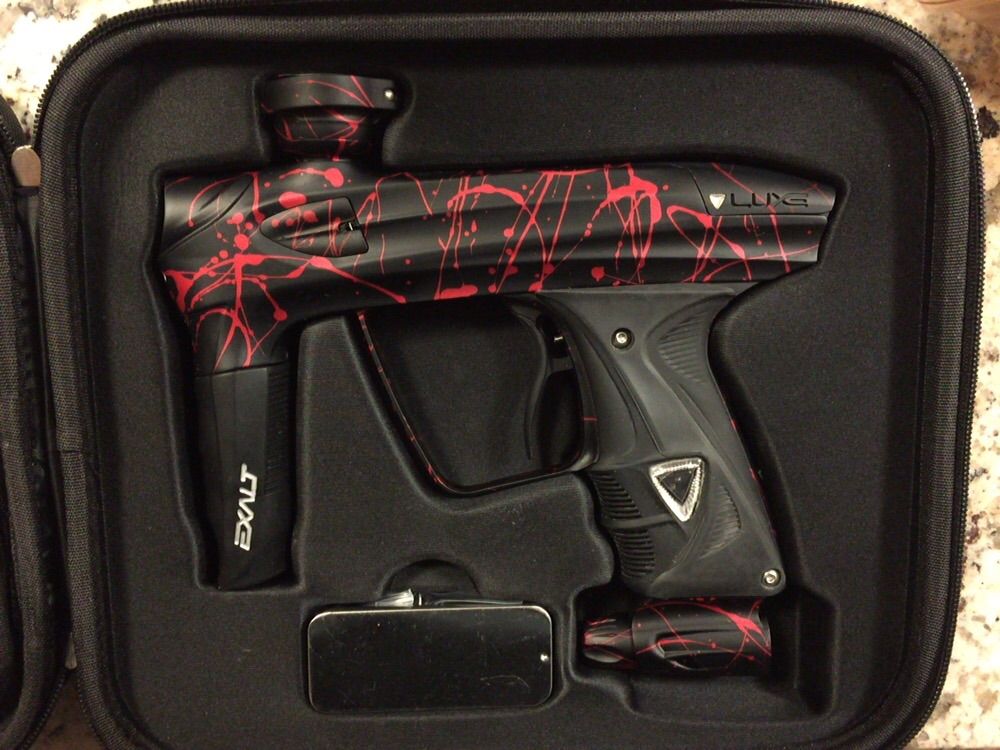

Distilled. I follow everything by the book. I will post the pics, the camera on my phone is wonky. Dont laugh, I am a fragile young man with high aspirations. But I havent quit my real job yet ;-) Nor have I stopped pimping myself out..
yes yes, I know there is a spot near the eye covers that didn't dye... that's what I get for having the GF clean it.. :-( (judgement should be displaced)
The color is harder to tell but it is like cherry coke red
then the yellow came out as intended.
Again, this pics were late last night without much light so the coloration is hard to tell. Damn circuit breaker in my room is wonky

That is what I was going to say. ^ Also what is the ph of the dye? (you can buy a cheap ph meter off ebay from china)
If you are crushing the matrix by laying it down you have something wrong. I have a towel that I lay down and lay the parts down. Hanging them is a good idea to.
What temp are you anodizing at? Acid concentration, ASF?
That is the deep red It was one of my first dyes and I've never had any issue with it. It was the deep red in powder form so prolly not from caswell. Its funny because I've never had any issues with my powder dyes, but caswells I have.

I'm not sure about the light fastness of them. Caswell has always boasted about the light fastness of their dyes.
All your temps sound good. Just as a test try going up 2 degrees in temp, Maybe adding some acid.
After you check the dye ph of coarse.
The splotch on the asa looks like drag over. You can fix the splotches by bleaching, 1min in acid, I like to let the part dry if I'm doing a solid color.
Don't forget rinsing ^^
http://forum.caswellplating.com/anod...ng-dye-ph.html
Use battery acid to go down and ammonia to go up in ph.
