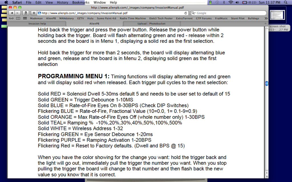

does this make sense?

as far as settings go, stock tends to work best.
red - dwell - 12ms
solid purple - eye delay - 2
2 flash purple - ball in place delay - 2
firefoxx04 is offline   Reply With Quote

yeah, but the colors are off. i think the invasion board is a little different then the indy.
