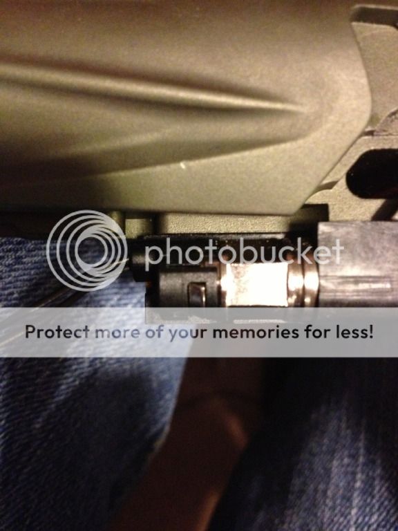

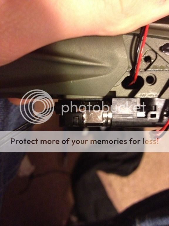

I managed to get a some pictures of where the gasket is still showing when the solenoid is snug to the body
Degassed:
Aired up:
iceman9820 is offline   Reply With Quote

Originally Posted by iceman9820 View Post
Chuckles, since you seem to be the only one willing to help, do you mind getting a picture of the solenoid to body fit while it is gassed up? I purchased a new solenoid housing and there is not immediate leak like I was getting with the original housing, but there is still a small gap when aired up but looks to sit more flush when degassed.
Degased
Aired up
BDidz is online now   Reply With Quote

Thanks BDidz for the pics
