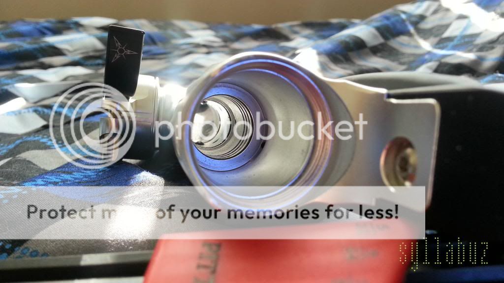

Sorry fellas but TechT has no way costly to make an engine for the marker due to its design.
The one and only way they could do anything is if they built a can that the bolt inserted into to bypass the "ABS" grooves in the breech.
Such an item as that would cost roughly between 110-130$$, and make the face of the bolt roughly a .60cal
So, due to the "ABS" groove design there will be no TechT engine for this marker.
Test were ran however in comparison to a stock G4 bolt and nothing was different in anyway aside from a slight change in sound..

looks fun to clean... also looks like it holds lube.

I'm still not seeing how those grooves help combat bolt stick. They have no contact with the bolt or do anything like that. The only thing I can think of is that by increasing the volume the solenoid has to fill to push the bolt back, they're slowing down the return stroke, trying to smooth out the shot as much as they can.
