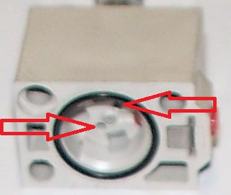

Right one goes in the mirror of the left one.
Those pins are pushed by the core (metal piece with the spring on it) to open a seal on the other side of the housing. That releases the air from behind the pilot and allows the noid spool to switch back.

That's how I have it so it looks like the noid is bad :-(

as long as you're able to find one that works. glad it's fixed.

Just curious but was the sail o-ring you had trouble with too tight or too loose?

To be honest i cant tell. When i pull the bolt through the bolt sleeve i can defiantly feel drag, but im not sure how its supposed to feel. I did put a slightly fatter oring on the sail and the thing would hardly cycle. With my current oring it works 90% of the time but it still does have what seems like a loss of pressure to cause inconsistency sometimes. Im hoping i just need to break in the bolt and the sail oring.
