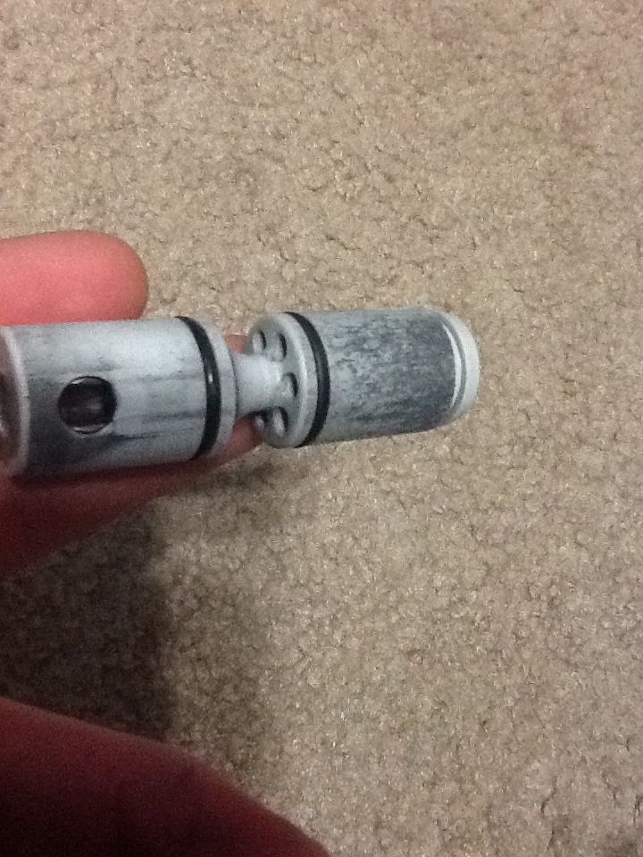

I think it's kinda beyond the point where urethane orings will help. My main concern isn't getting more breech wear, but more so keep it from shredding through an oring a day.
And here's some pics, the first pic is the breech the best shot I could get of it, the second is the top of the bolt and the third is the bottom of the bolt. And the reason there's no oring on the front of the bolt.... It shredded a couple days ago when I put a case or so of paint I had laying around through it...
Keep in mind too that this gun has had countless upon countless cases of paint through it (although because of this it's the smoothest ego I've ever shot, and I love it).

I have seen this in so many egos. At first I thought these people must be picking up dirty paint to shoot through. Maybe the inception of speed feeds allow dirt in. Then, I have to think the very short bolt is allowing tilt up/down in operation and so the front of the bolt rubs more aggressively.
For example, my old Freak Factory Impulse has no o-rings on a delrin bolt and the breach wear is light. Possibly the anodizing is better/thicker than that on Egos.
In any case, this can be fixed, but not economically. You can certainly smooth it out. If very well cleaned you may even be able to fill in the gouges with an epoxy of some sort, but I wouldn't recommend it. The flex hone would work but I don't think it would be worth it. Just use sand paper and your finger.
If I was bent on saving it/o-rings I would probably bore out and install an insert to resurface it. Possibly use brass.

Another thought I had is, what is that bolt made out of? If it is a glass filled material then it may be significantly more abrasive than other materials.
I know it's delrin (it's a techt hush bolt for the ego), I don't know if it has glass in it or not.

I would put an inquiry out to see if other hush bolt users are seeing the same extreme wear in their guns.
I currently have an ego11 with dart bolt in my possession and it is showing early signs of the same problem.
The ego lv1 is not, but it simply hasn't been used much.
