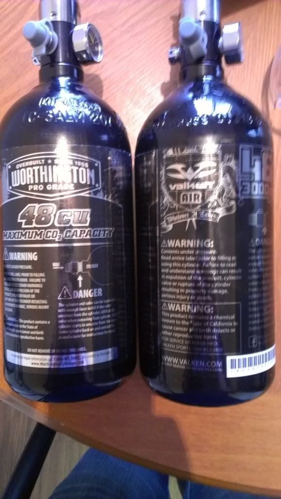

Old 01-16-2013, 02:10 PM #38
KINGKILLA21
YaKnOwWhOeH
KINGKILLA21's Avatar
Location: CANADA .EH?
KINGKILLA21 has achieved Level 1 in PbNation Pursuit
KINGKILLA21 has perfected Level 1 in PbNation Pursuit
UPDATE:
So i got the tank in the mail today from worthington and it was interesting, heres a pic the one on the left is the old one and the one on the right is the new one

Old 01-16-2013, 03:03 PM #39
die.another.day
die.another.day's Avatar
Take a pic of the front of the new one

Old 01-16-2013, 07:08 PM #40
KINGKILLA21
YaKnOwWhOeH
The one on the right is the front, i guess valken bought out worthington

Old 01-16-2013, 08:44 PM #41
die.another.day
Hmm. So it should still be a ****ty tank
die.another.day is offline   Reply With Quote
Old 01-16-2013, 09:28 PM #42
KINGKILLA21
YaKnOwWhOeH
Just a normal steely in my eyes valken should be better than worthington
