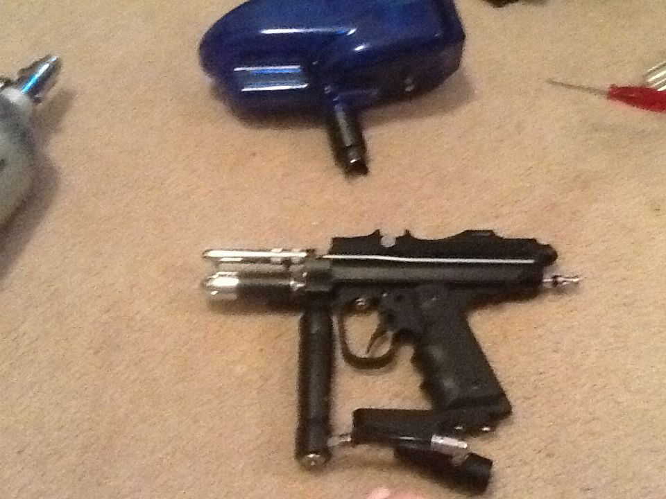

How can I fix this? The feedback came completely off. It must have been glued.

that is quite, um. OK that gun is F*****. If you have a buddy or if you can do it try welding that shizz back on, other than that there's really nothing you can do
http://www.ebay.com/itm/WGP-AUTOCOCK...item589993b617
http://www.ebay.com/itm/WGP-Autocock...em3f2047 d2f9
they're going to need assembly but if you can't weld it look at these bodies and rebuild it.

A new body might be easier/cheaper.
I've heard of people successfully using assloads of JB weld.

If that is a superbolt body then there should be a little set screw in front of the feed neck that you might just need to retighten.

Thanks you! That's all it was lol I was freaking out that I just waisted my money haha

Wow, it looks sheared off in that pic. Glad you got it fixed tho.

they're likely press-fit from the factory (at least WGP bodies are). Should press-fit back into place, but I'd use a touch of hardcore epoxy or green loctite as well. Don't get messy with it - a little dab'll do ya.

Did it snap off? in that case there is nothin you can do
