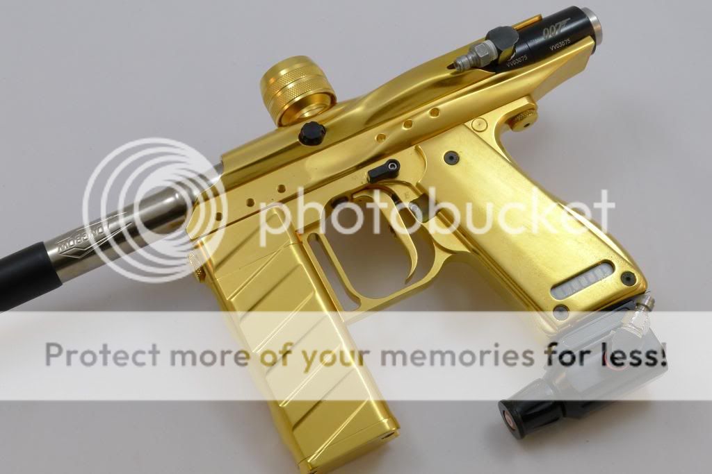

because you can create something like this:
Gold Plated Karta Emag. (I didn't make it, but I own it.)
