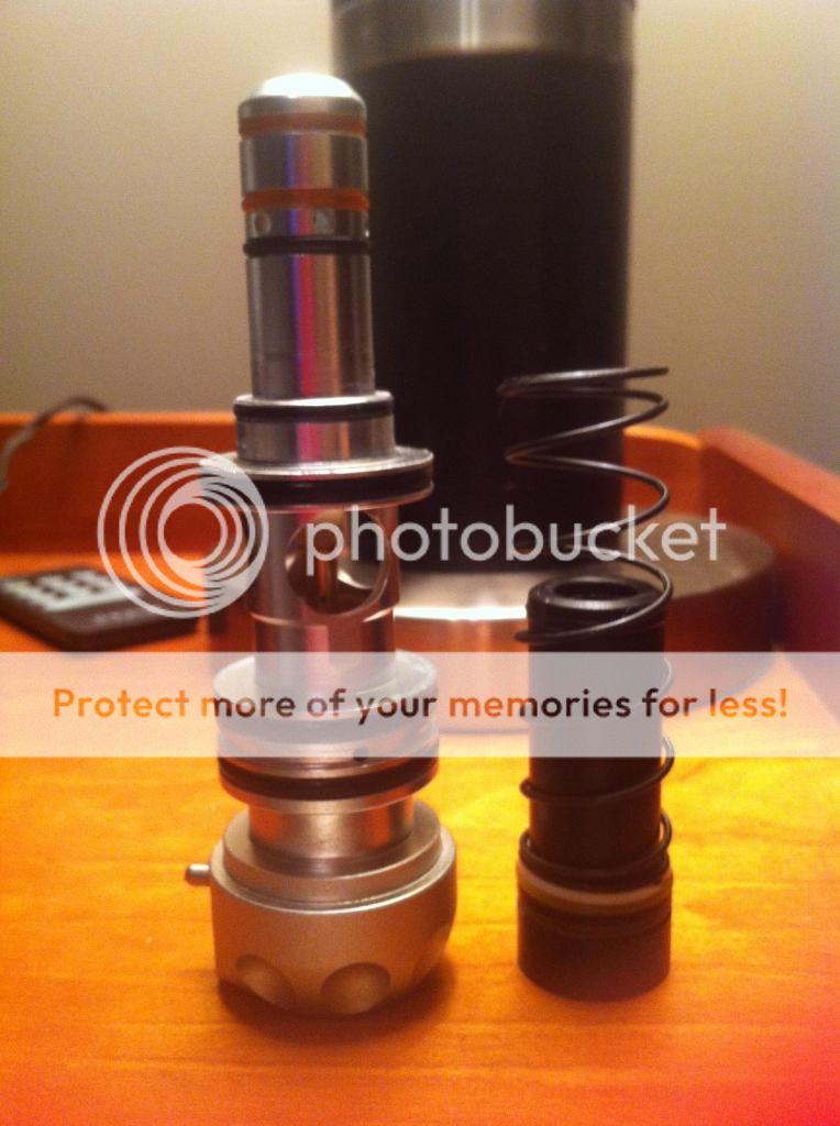

this is my set up right here

the bolt fits snug on the bolt guide, have to pull on it a little to pull it off. it fits fine on the spacer and with little force can be pulled up the spacer oring. Spacer is sitting snug, I can't even pull it off, bolts moves just fine in the breach with pushing it through with my finger
and i am using the stock spring

yep one of the 012 that lurker included. Tried the stock, long, and short and it just blew air, wouldnt cycle forward and how i know is because i stuck my finger in the breach haha
and on the bolt i have the white shock absorber, boss shock oring
