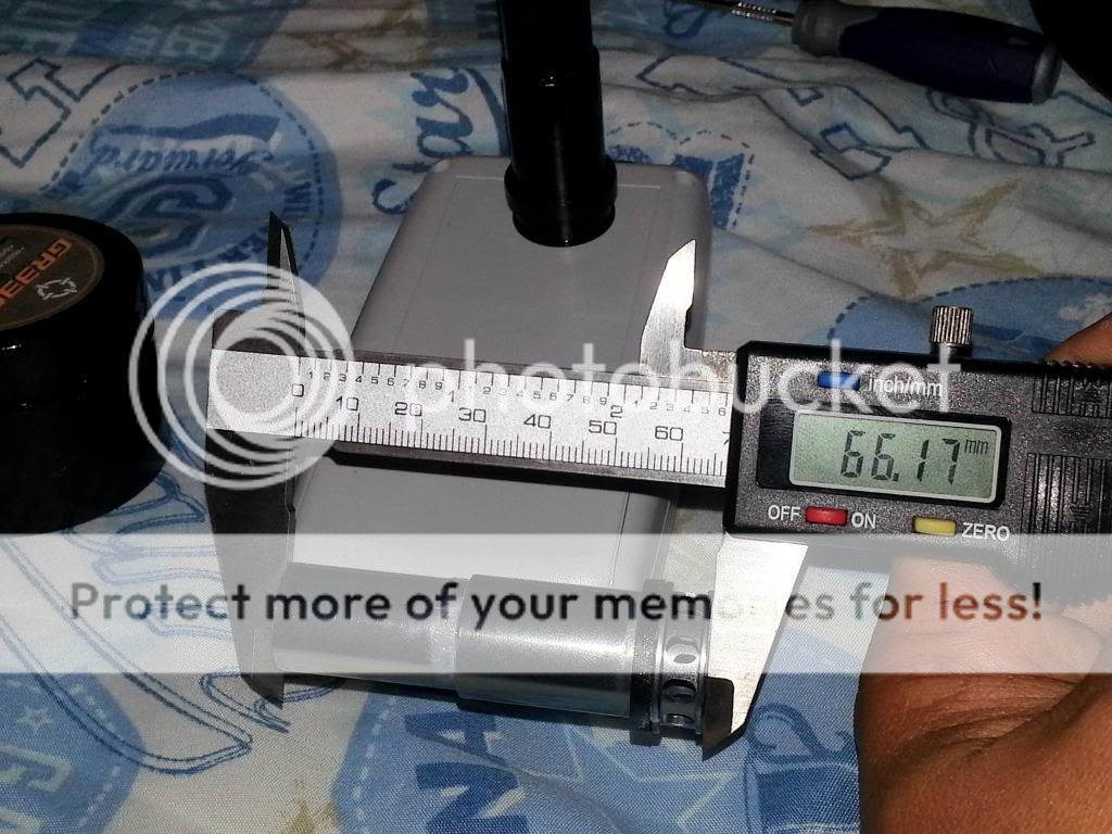

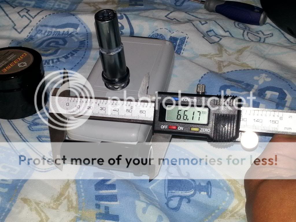

Thanks pote. Wanted to know if a g5 bolt would work in a g4. The g5 stem looks longer, Does g5 bolt maintain contact with with g5 bolt stem through complete bolt cycle and just dump through holes?
im not pote...
to answer your question...
[IMG][/IMG]
[IMG][/IMG]

Thanks syllabuz. I guess the both bolt diameter and the bolt stop location is the same also? Could you also measure stem distance off inside of back cap? Thanks man.

honestly other than bolt stick issues caused by too much lube on the back cap I can't really see much of a difference between the g4 and g5 bolts function wise. If you use an un-modded pmd you are also going to have to use the stock g4 bolt. The longer shaft on the g5 back cap is to compensate for those holes in the new bolt engine. If you used the g5 bolt with a g4 pmd the holes would drop off the stem oring too early and you would get a lot of air going up the feedneck due to the bolt not being forward that extra 1/4" and sealing into the front oring.....

upon further inspection there are more differences than just some holes in the back of the bolt. The g5 transition is more of a 90* than a chamfer also the transition is closer to the rear of the bolt on the g5 than the g4. Here are some pics of what im talking about.

I would say the new bolt never loses contact with the bolt stem. It looks like it uses the holes to dump the chamber instead of floating off the bolt stem like it does with the other g series.

Thanks for pics and measurments pote.I would agree with disturbed bolt prob. never leaves stem. It's prob quieter than stock g4 bolt due to the way it dumps air, 90 degrees dump to ball/barrel plane. May be a tad more gradual air dump, less pop becuse holes open a little more gradual vs. g4 bolt. To bad techt bolt engine dosen't seem to work with g5.
