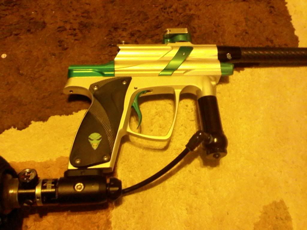

Epoxy to seal inline air hole?
Replacing an Invasion's stock inline regulator with an AKA SST and on/off. I can not find a rail that is fat enough to cover the air hole at the bottom of the grip frame. An old school Hybrid rail almost did the trick, but not quite. Looks like I have to plug up the hole with some epoxy.
I was thinking JB Weld, but maybe somebody else has some ideas.

That doesn't sound like a good idea to me. If you know anyone that can tap some threads in the hole and then just plug it with a screw that might work. Plus you could also remove it and return the gun to stock setup in the future with a quick removal of the screw.

I highly suggest not to use JB weld or any sort of thing like that. It looks ghetto and absolutely will ruin the value of the marker.

Well the ship has sailed.
Mstrkey, looked into a self tapping screw, but the hole is too close to a side wall. It would have tapped out too much metal for the gun to hold its integrity.
I used JB Weld Stik, which was easily formable to the hole. Looks very professional actually.
The Invasion is now shooting great with an AKA SST on a generic on/off. Planning on getting a new on/off soon.

JB weld stick? Nice, I never heard of that. Looks pretty good actually. Nicely done.

my worry is being able to remove it? I feel like jack would have had an idea, he designed the gun to be able to do what you just did but im sure he didnt have jb weld in mind.

Not planning on it haha. And if I did, I am pretty sure I have the only one w/o the stock inline, so that may be an incentive if I do decide to sell.
In terms of removal, the stuff is pretty permanent. I would likely have to drill a hole through the epoxy, then dremel a seat for the oring in the epoxy itself.
Should be pretty easy, but so far every aspect of the gun has improved with the SST and on/off. Efficiency, consistency, and my LPR is even running in the high 60s, give-or-take!

how do you know where your lpr is at?

Before replacing the stock inline regulator, I sweet spotted both the inline and LPR to 300 FPS. According to the manual, that would have gotten my LPR in the ~75psi range.
After installing the SST and on/off, I was shooting around 330fps w/o adjusting the LPR screw from the previous setup. I re-sweet spotted both regs, and the LPR is now about 1/4 - 1/2 turns out from where it was previously, still shooting +/- 2 at 300fps. I assume that would put me somewhere in the high 60s, maybe 70psi.
