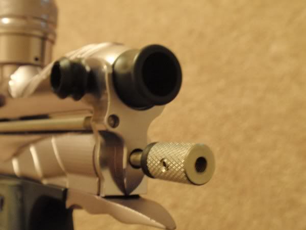

Here is a link to one I had previously. This one is pumped, but you can see where it had the back block drilled for the cocking rod.

that's not a Karni w a drilled bb. it's a Black Magic w a Karni BB and ICS system.
this is a Karni w a drilled BB
