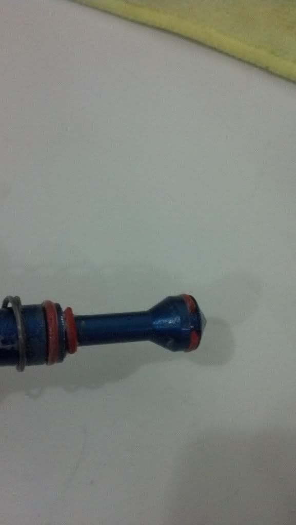

No luck on my end. When I first got my eigen bolt i used a microfiber cloth and some Sp sleek and hand polished the bolt, hand fit the orings for a nice fit. I shot maybe 2 hoppers adjusting dwell and input pressure. Got it all figured out shooting decent and put it away.
After that i shot a hopper full of reballs just goofing around. I then had company over and let them shoot a hopper with my shocker again just goofing around. well about half way through the hopper i could hear it developing a leak. I then stopped and decided to see what was going on.
Starting taking everything apart then noticed this on the bolt guide. The bolt guide o-ring supplied with the eigen have swollen and one actually has broke.
So far I'm not very impressed overall. I guess now i will wait for someone to find the magic o-ring for the bolt guide.
CerberusVI is offline   Reply With Quote

buna 12/70. They fit decently, and don't swell like the red silicon ones. The new size of the ring will be found soon hopefully.
This^. And my red guide o-rings did the same thing. The lube or pressure swells them.

The #12 HNBR o-rings I used work great.

Mine swelled and did the same........ Put the stock clear orings off of my other sft bolt guide and lubed the piss out of it and it shoots fine now just have to lube the hell out of it about every 500 shots or it sticks and is dry as a bone
