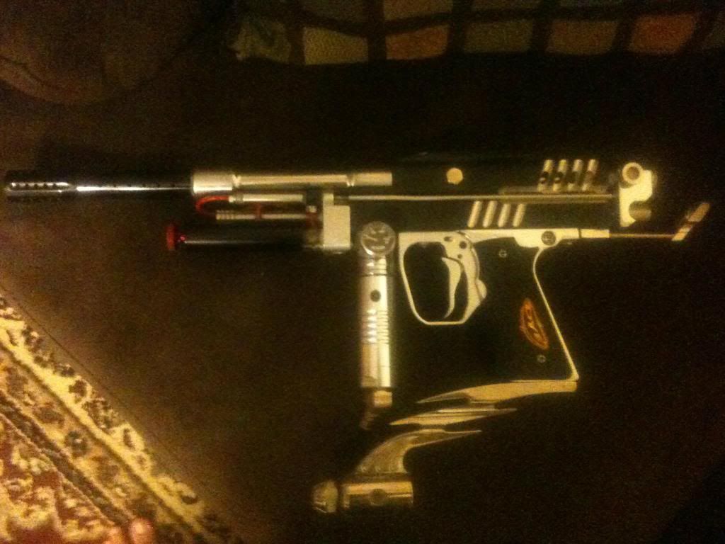

Alright gents I have a right feed auto****er my dad bought in maybe 04? It has been custom milled for sure other than that I have no info.
(Is that an old eclipse trigger assembly?)
Gun was bought at PBUSA in Houston way back when, maybe someone will recognize it.

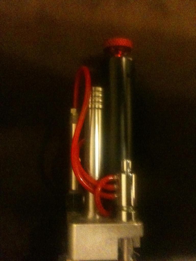

(Any info on the reg, 3-way, front block assembly?)

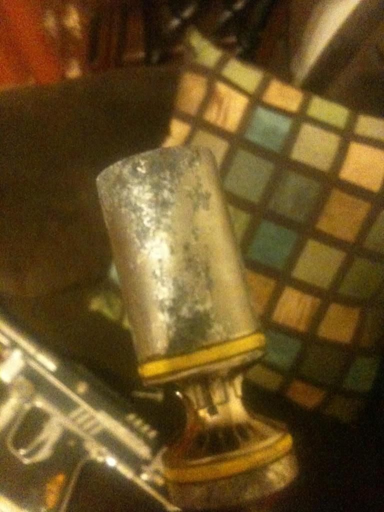

My brother, who can not have anything nice, used the ****er a while back and apparently never cleaned it after he broke a bunch of paint in it. Needless to say after taking it apart and cleaning it the bolt looks like this.
(I was thinking of wetsanding and polishing but I think the corrosion is too deep, what do yall think?)

the 3 way is a shock tech "bomb" .. the ram looks to be ANS , and the LPR looks like either a Shockteck or a Palmer's Rock with a knob .. and the bolt should be fine if you sand it with some really fine sandpaper and get it smooth.. and yes that is an Eclipse Hinge .. which is very nice BTW ... have on on my free flow

Yup, Shocktech bomb, and LPR. Ram is an ANS. I would honestly recommend throwing the bolt away before it causes problems in your breach. The bolt is nickel coated, it's been corroding and the nickel is no longer there. Also looks to be a MacDev Gladiator V1 HPR.

Awesome thanks its always good to know whats what haha. But ya I would say the coating is flaking. Anywhere to find a good delrin bolt?

I played today at a local field, with a different marker, and left the bolt with the proshop. They are going to try mediablasting the nickel coating off maybe polish it. If it doesn't work i'll buy a delrin, thanks for the leads on where to get btw. Either way i'm determined to get this gat going.

That's a lot of work when you can pick up a stock WGP delrin for $12
