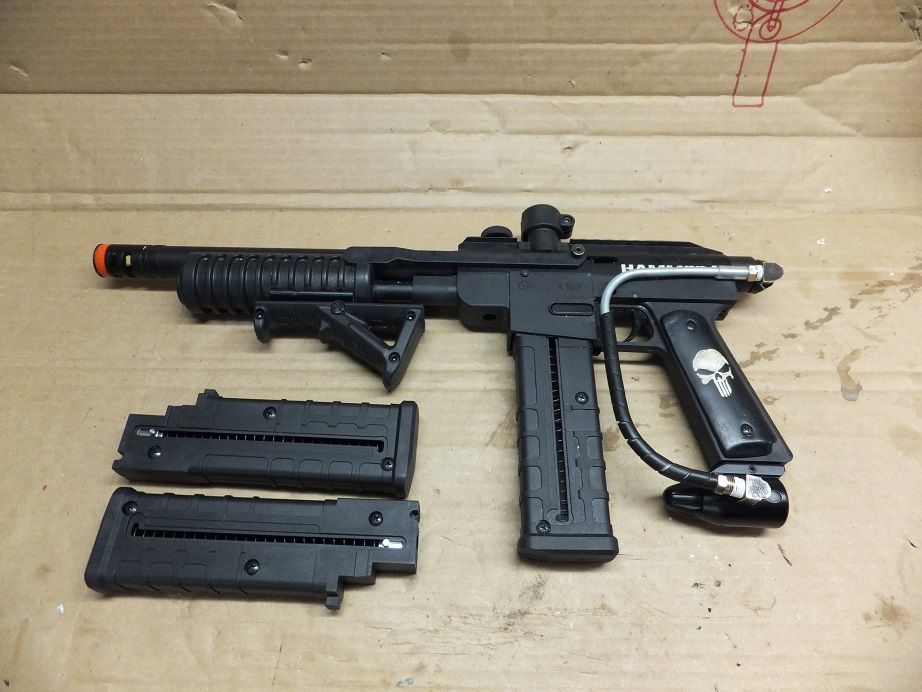

My favorite toy lately.homemade cast Punisher grips,Nonnoms speedwheel from MCB,CP ASA&homemade airlines using brakeline,added a M14/10-22 short rail to pumparm with Magpul front grip,added some Dye lube to the pumprod for smoother pumping.Kept the stock barrel,thinking of a J&J ceramic,curious to see your FS impressions with this barrel Snausage
Trying to keep this build under $300 total,its creeping up fast
I'll be playing my 1st scenario this weekend trying out FSRs,looking forward to some Hammer 7ime,will update my review thread after the game

I was entertaining the idea of a grip on the pump handle, too.
How do you like that? How did you attach it?

Actually I like it alot,angle is a little more user friendly.I got the mount with a bipod I used on another project,its for a Mini 14/10-22 rifle style stock adapter,theres also a sling mount built in I havent used yet.I greased the spring and pumprod with some spool valve grease to smooth the action too.
Tried a normal folding style foregrip,with the 90 deg. angle it made the pumpstroke bind a little,with the Magpul grip on there its not an issue

NP.Forgot to mention I "milled' a few of the ribs of the pumphandle to get the mount to fit,used a dremmel bit in my drillpress

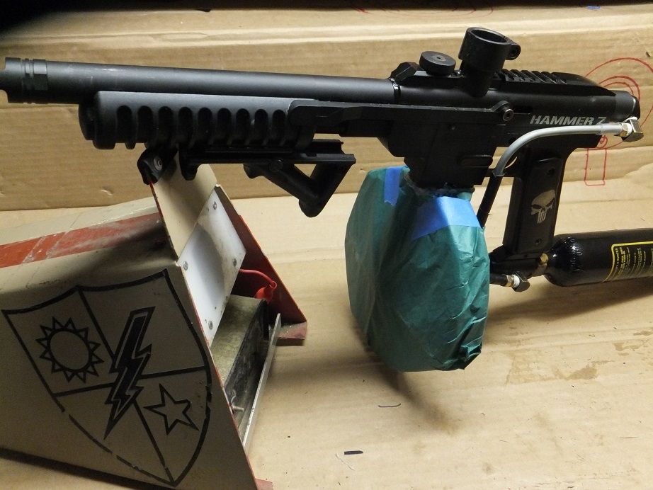

Heres a teaser pic from my latest project.20+FS or PB rounds,bench tested the feed last night,field test at the end of this month,still need to make mag to drum supports,its currently held together with hotglue,duct tape and unicorn farts.
Hoping to produce them by late Sept. if it works as planned.Also have 2 more versions in the works,a smaller higher capacity one and a offset right version.SHHHH.. its a seacret Im keeping it under wraps untill then

Don't forget the dual drums!

gotcha covered,must be a mind reader,will be the third prototype
