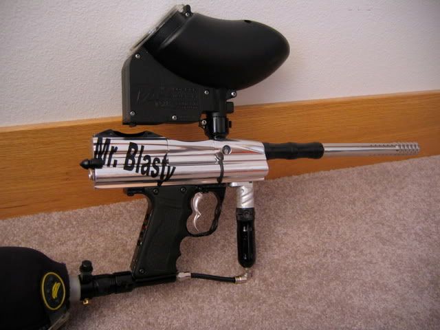

So my buddy has an angel and we cannot figure out what one it is. I looked through the threads with no luck. I believe it is a LCD bit that is all I know. Thanks for the help

Looks like a stock LCD, 2k, 2k1 or so.

What is the difference between 2k1 and 2k2. I know it says bonebrake on it. My friend said that. Was some kind of upgrade service

Dan Bonebrake did upgrade packages with anno for several guns back in the day, Angels being one of them. Then he started doing "Bonebrake Edition" guns that were just anno with a sticker on them. This is most likely just a sticker on the body, rather than any real upgrades. There's CP stickers on there, too, but no CP products.
In 2002, the stock milling changed from the slab sides you've got to a mill job with some body lines in it... like this.
Pump Scout is offline   Reply With Quote

I see thanks for all of the info. My buddy just pulled it out of his gear bag after not playing for about 7 years. We are thinking about making a comeback lol. Do u by any chance know if there are still places to buy parts like board and battery's for these guns. I think his board is fried. And are the
Boards all the same for 2k to 2k2 angels. Thanks again

boards all the same, and no they are not available.
Cheapest option is to mount a pmr rail board in it and drop the battery board all together.
the bonebrakes, if i remember, "honed and polished the internals", etc.. Other than that was just a sticker.

2k1 stock LCD. The Bonebrake sticker is most likely just a sticker. As was said, the Bonebrake mods mostly just consisted of porting and polishing reg pistons anyway.
You can still get battery replacements and sometimes find stock boards, but doing the PMR board mod is very convenient and gives you more modern firing modes so you can comply with tournament and field ramping rules (if you want/need to). You do lose the LCD screen though, if that's important to you.
For parts and service, www.fixmyangel.com is the place to go. If you can't find what you need there, www.pbsports.com also carries a lot of older Angel parts (though most of their stuff seems to be for the A4 and up).

So is there a thread or possibly a video on how to do the pmr board mod for the angel. Thanks for all the info

http://www.pbnation.com/showthread.p...ight=pmr+board
To make the installation even easier, there's a couple fellas here at PBN selling nylon inserts pre-drilled to hold the board in place and mount the microswitch.
