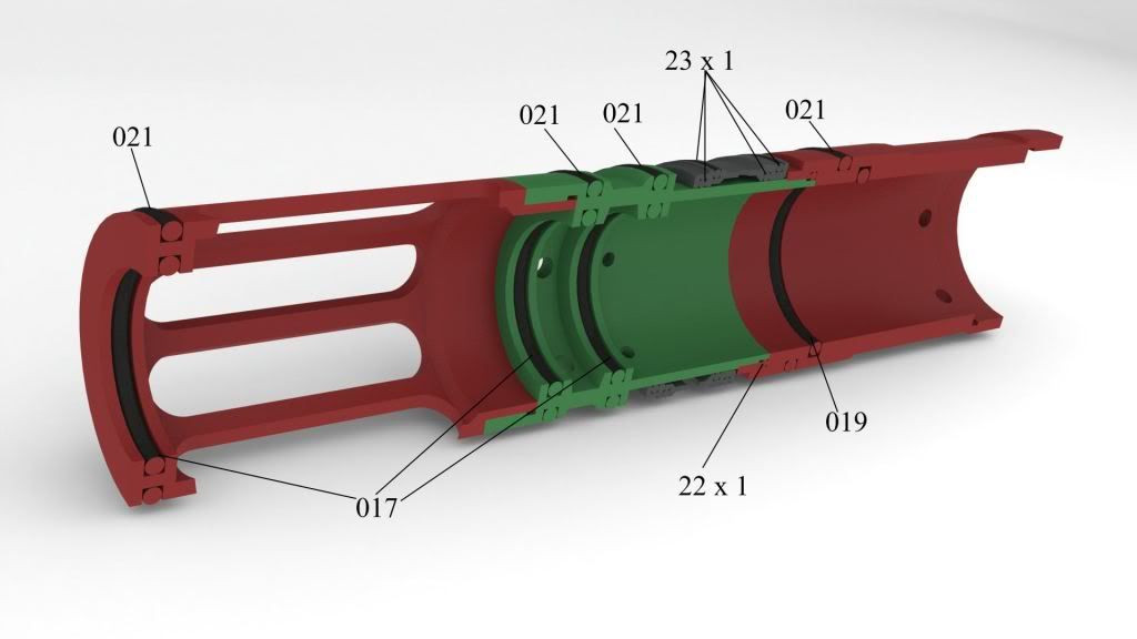

Is there a list of the o-rings that are on the 2013 demon bolt or updated manual with diagrams of the new bolt system?
Trying to find out what orings I need to buy

That's actually one of the best oring charts I've seen ever, for any gun. Without the cut away, it can look a lot more confusing, but this is perfect. Good work whoever did this!
my god yes. Now for them to do this on every part of the gun and upload them

Just curious what size are the 2 orings on the bolt guide? Thanks in advance
4 O Rings, from front to back, 011, 806, 806 (bumper) , 017 that's seals in the cap

o okay thank you, wasnt even thinking about the bumper or cap one

Does this diagram also apply for the upgraded 2011 and 2012 Demons?

Yes, it's the same parts
