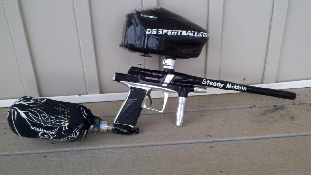

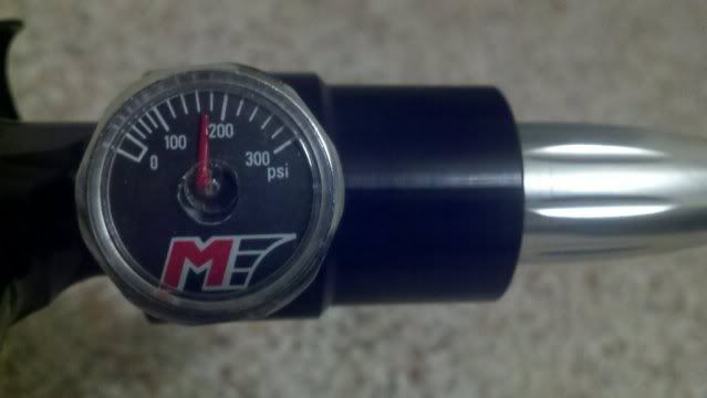

Ultimate Settings Thread For G6R Users With LP POPPIT
Ok guys so most of you know I've had the LP Poppit installed in my gun for about a month now. I've been getting tons of pm's asking questions about it, so I'm making a thread about my pressures and my current AWESOME settings. My HPR is set currently at 180-185 psi.
and my LPR is currently set at 60 psi
I am running a dwell currently of 4 with zero dropoff or sputtering. You may be able to tweak these settings slightly for optimal performance from your gun, but with these settings in mine Im shooting consistent 290's with about 2-3 fps fluctuation. If you have any questions post up here and ill be sure to answer them to the best of my ability. And if anyone else is running the LP Poppit post up with your settings so we can see what the best settings are to run thats consistent in everyones guns. Thanks and again feel free to post up any questions or thoughts yall have!

Colorado it looks like you are at 170 hpr and 64 lpr in the pictures you posted,that's some nice working pressures.

Hell yeah man its a super soft quiet shot and shooting consistent 290's with zero breaks yesterday in 50 degree georgia weather shooting super brittle DXS Gold. I have yet to break a single ball in this gun. Although I did smash a **** ton of it in my hopper diving into the snake lol.

broo that carbon boomstick look good on the g6 thanks for the thread
