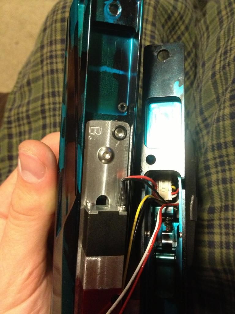

Clone GT - Small O ring floating around
Just got my Clone GT and noticed this little o ring when I took the grip off.
I couldn't see where it may have come off from and the gun was shooting fine. I'm wondering if it came off from something that it should be on or if it just got in there on accident.

If it's shooting fine and you have no leaks then I wouldn't worry about it. There are only a couple of places that o-ring could have come from.
It looks like it's a 2x1. There are (2) 2x1's below the solenoid, and 1 of them on top of subplate A between the subplate and the foregrip.
You could remove the foregrip and solenoid to see if the o-ring is missing from either of those places, but again, if it's not leaking right now I would just leave it alone and continue shooting people!

This could of happened during assembly that an oring got stuck to the board or the underside of the marker then bolted together. I've seen it once or twice and it's nothing to be alarmed about if there are no issues currently with the marker.
