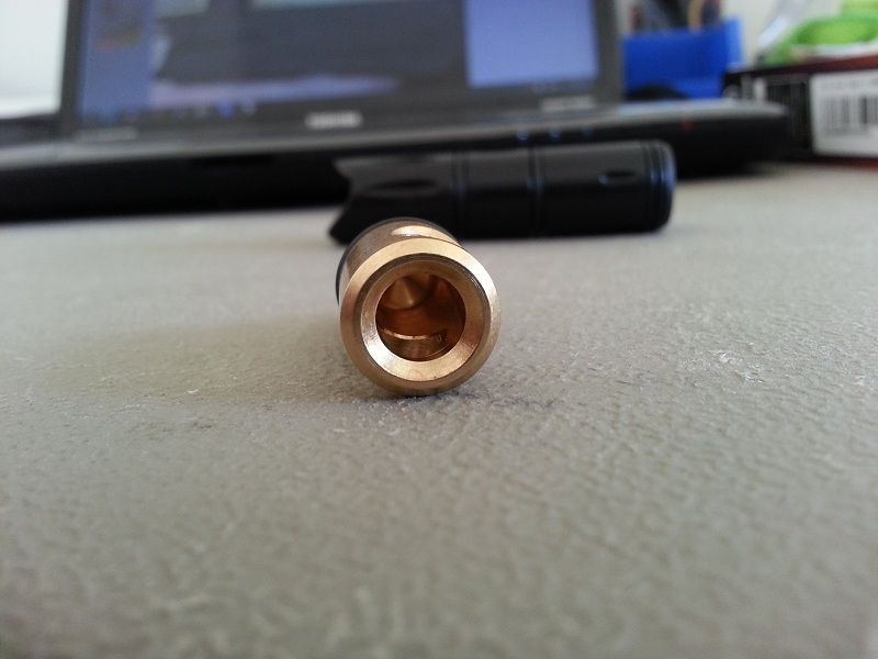

Here are some pics of the insert.

just thinking out loud..... no argument pleasse, no debate....
An LP valvue to make it even softer shooting but less efficient, 2 orings to compensate efficiency after make it softer and a weighted bolt to use innertia to gain so efficiency ..... just wondering how it shoots compare to a stock 11, hushed 11 and pooty 11
Also wondering why the weighted insert can be removed (since it comes with an oring) when it couldīve been non
