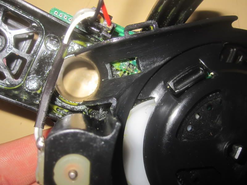

Hi, looking for some guidance/advice here. I have a Z2, only a few months old and inside along the race where the clear glass is, broke, and now my hopper constantly blends paint. How can I get this replaced? It's a physical breakdown, and I don't know how it happened, I haven't heard of this problem before and found nothing searching the forums. Does anyone know if Empire has replacement parts available? Thanks in advance.

Just call Paintball solutions and get a new eye cover. If that eye cover isn't broken you can just snap it back into place. Make sure you snap it in the right way around so that it is flush.
