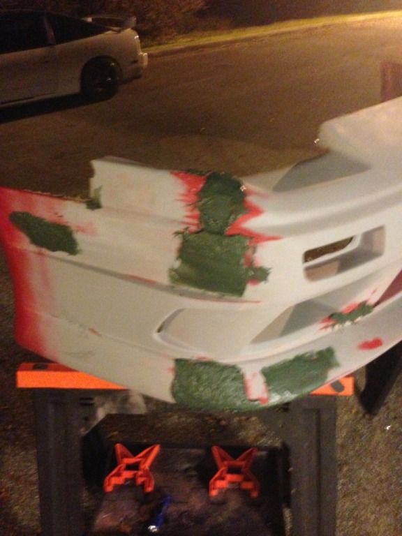

Sanding some aero today. Wish it wasn't so humid out so I could paint. Got that s2k hardtop ready for primer, sides ready for paint, valances ready to paint.
Bumper had several 6+in cracks, zip tie stitched, lip destroyed. Reinforced and side markers deleted

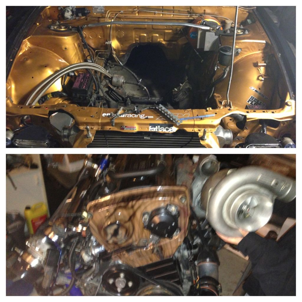

I'm back. Here's my Cressida drift project I've been working on for almost 3 months. It's almost finished as I am halfway through wiring.
Basic rundown:
VVT-i 1JZ-GTE swap
R-154 (manual conversion)
Megan coilovers
Serial 9 adjustable EVERYTHING (suspension/steering/bushings/etc)
4-piston 300ZX front calipers w/ braided lines
ABS delete
4.3 MA70 Supra welded diff
13lbs Chromoly flywheel
Factory garbage bypass valve delete and replaced with recirculating OEM STi BOV

what wire harness did you go with for the cressida, me and a budy have gone through three. the current one is off a jdm soarer but its not working out. thinking about just going with a dr. tweak harness but they are $$

I'm using the factory JZX100 auto harness and splicing in the old 7M plugs. I decided to extend the dash plugs 18" for a factory look instead of cutting a hole in the firewall. This is my 6th JZ swap so it's easy for me. I refuse to pay Dr. Tweak's insane prices.

That Cressie's in the US? I thought we never got them here, but I could be mistaken.

Yes, it's a USDM MX83. They all came with 7M-GE's and were all automatic. I swapped a JZX100 VVT-i 1JZ-GTE out of a 1996+ Chaser and added a MKIII Supra R-154 transmission to it. It's far from plug-n-play.

Nice project. I love the Cressidas. I'm actually looking into the same engine/trans for the IS.
