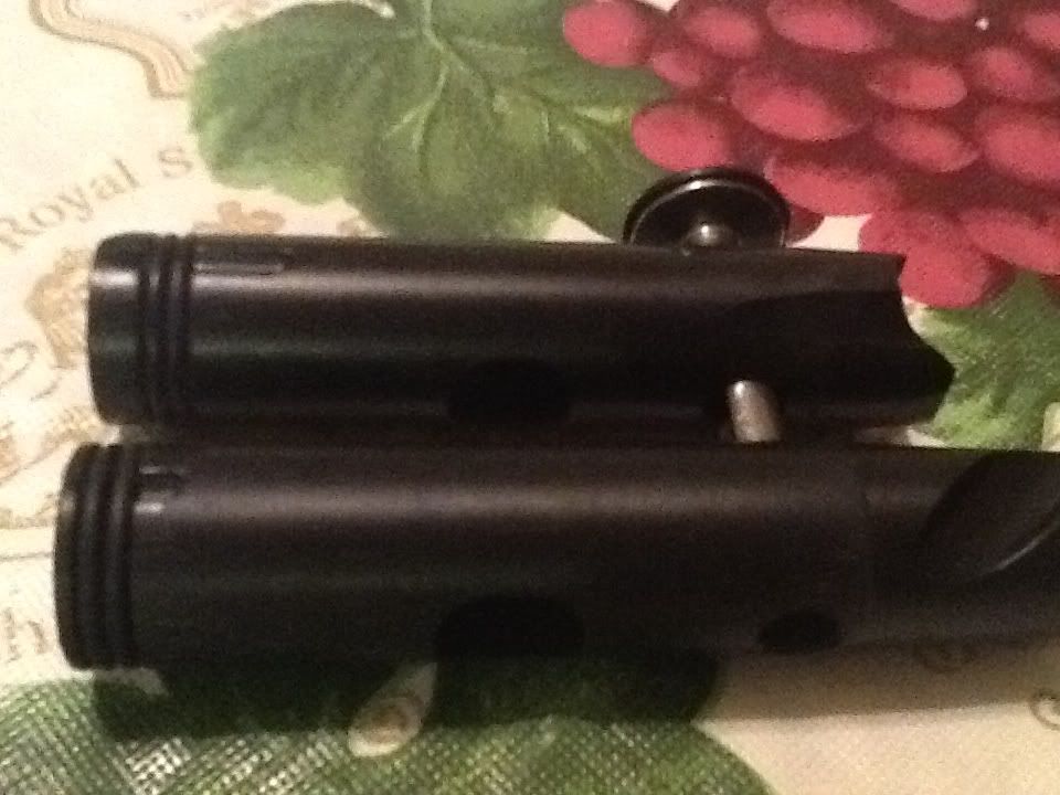

^Cure3+ in forward firing position^
^Cure1 in forward firing position^
^comparison of length, note the C3+ is shorter but the front of the bolt protrudes farther forward to help with roll back.
Comparison of inlet positioning.
I want to switch between the two Cure bolts when I play next time and see if there is any difference over the chrono and in sound signature. I just wish I had a second bolt pin so I didn't have to switch it out to do so..
