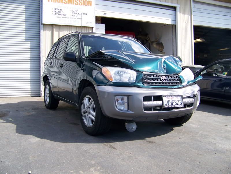

the core support will take some time but you might be able to put it back into place. it isnt too bad of a job, you take it to a shop and they will give u a bill for replacing the whole thing. but most of the times bending it back will work. if were you i would hook a chain around a tree and back up (done it in the past with cheap cars when i dont want to do the work) and usually if ur carefull it can get close. finish the rest of with a BFH. youll need a new rad and condensor at the least. radiator will keep it running. condensor wont be needed unless youll die without ac. a hood and bumper can be source easily enough. either though an aftermarket body shop or a local salvage yard. maybe youll get lucky and find one in black if not take em over to maaco and have them paint matched. will look good. after that its all about aligning the panels

my sister is about as talented
she pulled this off last year. had it fixed in 2 weeks. ended up keeping about 2k of the insurance payout.
but this one i had to section part of the upper core support bc the part that needed to come forward ended up creasing from all the stress
