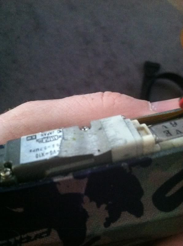

Sorry I totally forgot. I can't get a clear pic of the trigger but if you look down on the top of the trigger you can see the bearing sticking out slightly on either side of the trigger. You can sand the trigger in this area but be cautious as the material is very thin there
I sanded the noid as seen in this pic. There's more material here and allows you to use any trigger without further sanding but again be careful cause if you go to deep you will destroy the noid

How much additional clearance is needed with this? I feel like it might be a better idea to just shim the frame a bit. Cut a peice of thin plastic or card stock to fit between the frame and body, preferably along the entire length with cutouts for the wiring/trigger/screws. Zero risk and reversible.

Yea, if the problem is caused by the top of the trigger being pressed against the solenoid when the frame is tightened on the gun, then using some card stock or something to move the frame/trigger ~1mm away from the body/solenoid should solve the problem. Or you could grind the top surface of the trigger and solenoid, but you would have to be very careful not to go too far.
