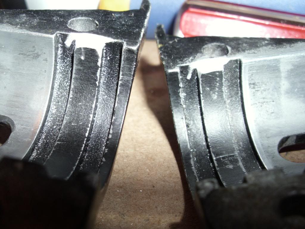

If you have the Model 98 or the first generation of 98C where you have the plastic rear sight there isnt much in terms of upgrades since that was all pre-cyclone and Egrip. Only thing you can really upgrade is your barrel.
If you want to get a newer 98C stock you can etch out a top groove using a Dremel 84922 bit to allow the stock groove to sit. I just did that on my Model 98 last weekend and slapped an Alpha Black stock on it.
