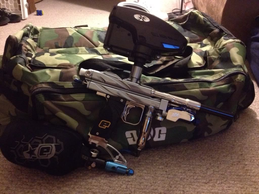

Willieocean14
Willieocean14's Avatar
[IMG][/IMG]
This pic was before i put the custom trigger, mini reg and beavertail on it but is still sick looking as is. Im kinda pissed tho cuz i scratched the hell out of the other side. Not really noticeable but to me i can tell boooooo!!!
Gotta see if my chrome shop ull fill it in for me
