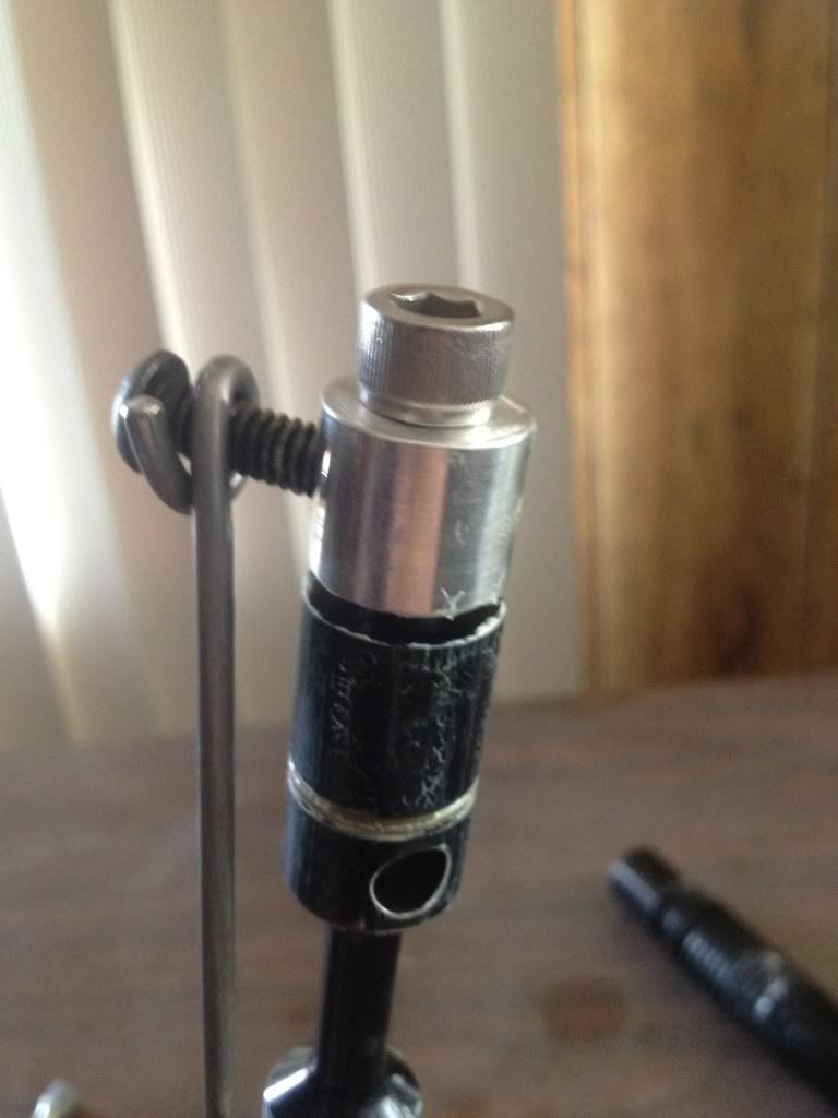

I decided to start this thread due to the amount of people who like to modify their spyders. Spyders are cheap, easy to mill, and have the potential to look amazing. These diy mods usually cost nothing and can turn a spyder into a gun you can show off. This thread is to post pictures of your diy modified spyder and for discussion about modifying them. This includes halfbacking, frame move ups, mini's spyders, spumps, custom milling, etc.
To start things off, here's my recently modded spyder:
I did the halfbacking job with a hack saw and some sandpaper/sanding foam. then I replaced the connecting pin with a longer cut-down nail to make the new cocking pin, it kind of looks like a timmy bolt now.

Here's the spump I did for a friend. Still needs some love but it works
And yes I know it is technically not a spyder
I milled the hammer and body. Made a delrin pump handle, turned a block to extend the bolt back, and polished the bolt very lightly, not enough to take off all the anno, but enough to really smooth it. (not that you can tell since it's covered in lube).

How do you cock the striker now that the bolt's not connected to it?

did you slot the striker? how did you do it so that you can move the pump handle back to its original place without pulling the trigger?
All you have to do is mill a slot in the hammer (striker). Start with the hole already in it and extend it all the way through the face of the hammer. same thing you do if you want to halfblock an autococker. Then the linkage pin is now a cocking pin. I didn't feel like taking it out for the picture

What tool did you use? I used a drill to try to make mine sode cocking.... i broke 3 bits and barely took the anodization of the striker, those things are hard.

The best way seems to be using a cutting wheel (such as a one with a dremel) the striker is made of hardened steel (or very close to it) and will only break bits of lesser or equal strength. For a dremel, the brown cutting discs will work, but you'll need alot of them. The best ones to use are the reinforced black carbide discs.
A bridgeport mill. HSS two flute end mill, it took like 3 passes.
I still have a bit of a to-do list: general body milling, a return spring, washer for the bolt extender, better way to connect the pump arm, under cocking kit, then probably a nice powder coat. If I get around to it ever
