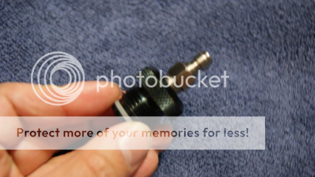

This marker comes with a nice plastic case, 2 piece barrel kit, small parts kit, tube of hater sauce and a rail so that you can use your own reg and asa. After I had purchased my marker I sat down with Chris Cole and he broke the marker down to explain everything to me about the marker and made sure the marker worked perfect and chrono'd before I went back out to the field. He had stressed a lot that I should make a pressure tester so I can adjust the gun and tune it later on. This can be down with either the gun attachment from a remote line or with a gas though grip with a gauge, just replace the front grip with your tester and you will be all set.
example of remote fitting that i will replace nipple with gauge
