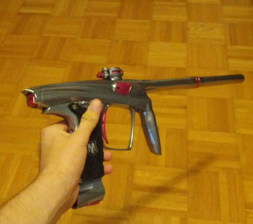

My new vapor!
Back to playing after 3 years off.
You can sell all your gear, but you can't get out and its more expensive to come back!
