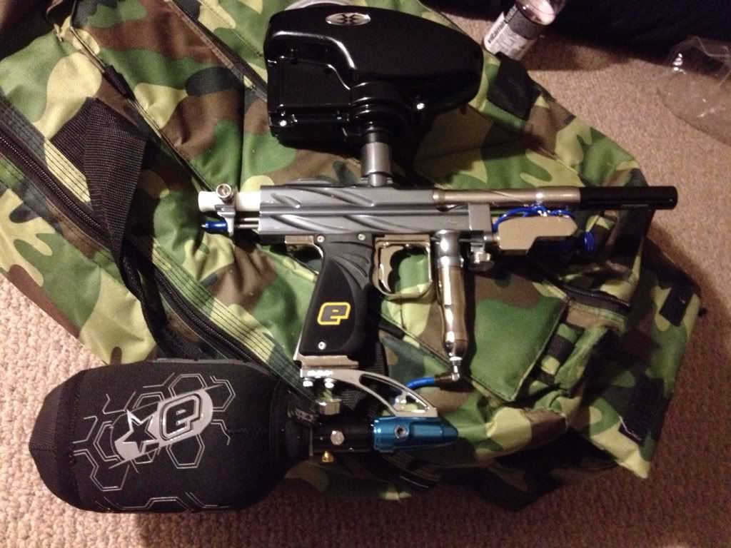

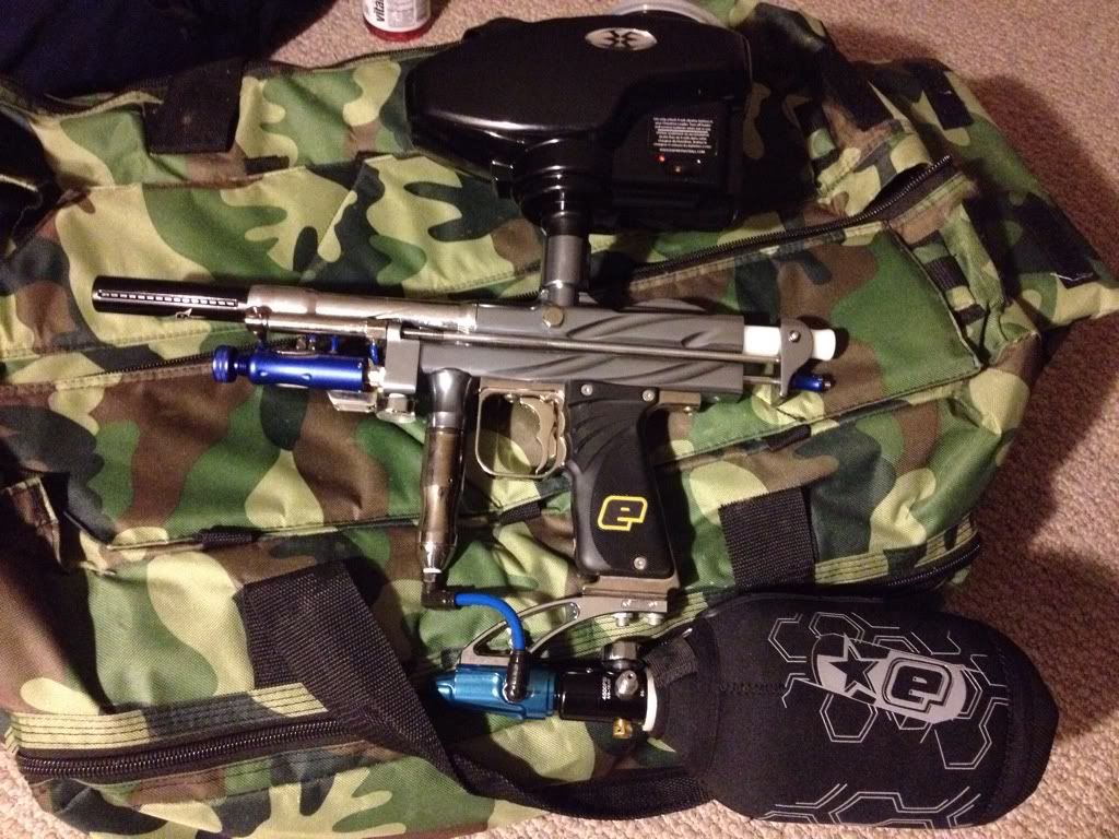

Need ideas... What else to add to my prostock
Just changed a few other parts out on my gun. New fittings all new air lines, jj shorty barrel front, back block , cocking rod basicly cosmetic ****.... Need ideas people on what else to add to the gun... And also does neone know how to or if it can be done to make a worrblade board accept more firing options ( full auto , ramping) if so please let me kno

if you want those firing modes just get a board that offers it

Does eclipse make another board that offers a full auto mode and other ramping modes? Also its gotta be a board that will run my worrblade manifold too right? I cant just slap any old electronic board in there its gotta be something that will control my 3 way manifold.....

You could change out the springs for the valve and hammer.. or at least just the main spring.

Scenario Dreams T-Board has those firing modes and is just a drop in replacement for the E-frame.

the e2 and zero b boards also have ramping. so does the tadao if your feeling fancy. they have MUCH better battery life than the E1 board too.
i really like the blue hoses/cocking rod knob, i think it would be cool if you could get a chrome lpr and keep just the blue knob.
does yours have the threaded feedneck? some of the later 04's did. if yours does you could get a clamping one.
im not a fan of drops
youd love having a different regulator that you dont have to take apart to adjust too.
wgp internals were always pretty good. no real reason to change them, but the maddman spring kits are cheap ($10) and allow for tuning that would make a bigger difference than a new valve/hammer.
