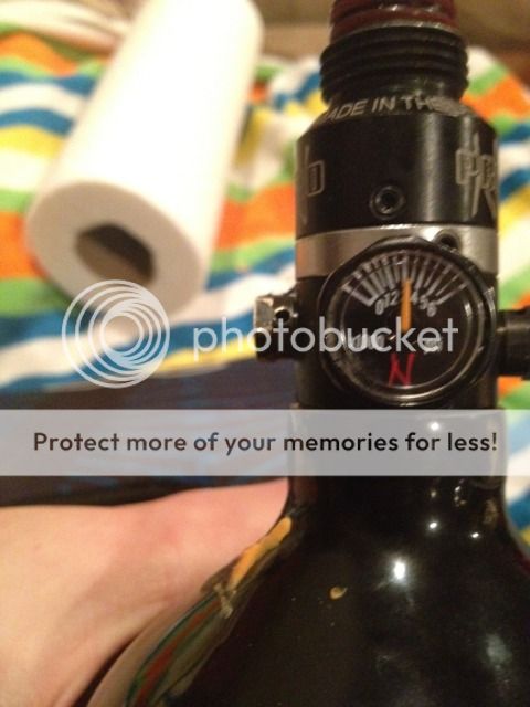

Ok this has happened twice now....when I go to turn off my asa the little lever is almost impossible to move. last time I had to take out the screw holding the on/off lever and basically take the entire Asa apart to get it moving freely again. same thing happened tonight...after being aired up for a few hours the lever will hardly budge...
any ideas?
any ideas?
had same issue with mine, i just took the asa all apart cleaned it up and checked every thing, haven't had an issue since.
