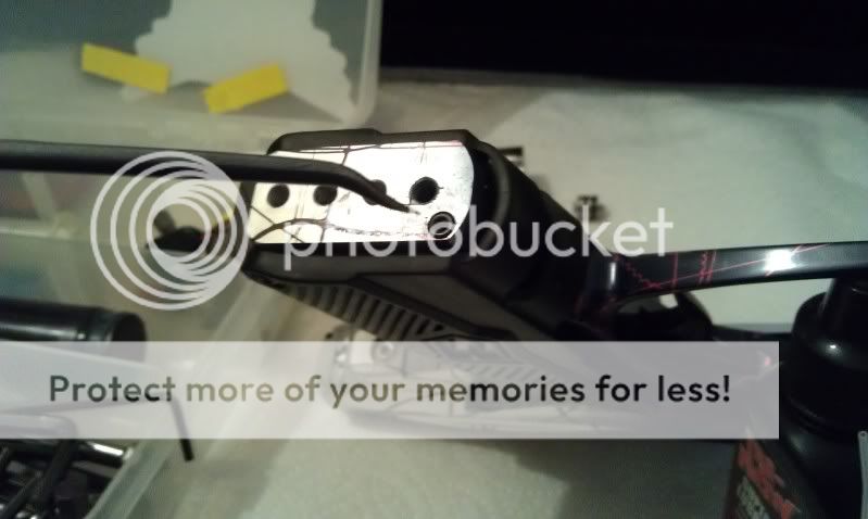

Originally Posted by juggernaught_lives View Post
if it is tiny like can fit in a drinking straw tiny than that is the Air Transfer hole from the ASA to the Frame
BTW that link doesn't work
Yes it can fit in a straw, so where would I put it back ?

Let me take mine apart and get you a pic

does this look like the o-ring that popped out?
juggernaught_lives is offline
Old 12-26-2012, 11:45 AM #866
Mclovins57
Mclovins57's Avatar
Yes sir!

Originally Posted by Mclovins57 View Post
Yes sir!
than that is the Air Transfer hole from the ASA to the Frame. Remove the ASA and put it back

Mission complete! Thanks guys.
