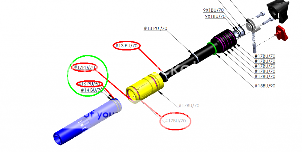

Vapor leak
I've done everything I can think of and followed ProMod's guide to no avail, I'm posting here hoping we can get this fixed before I have to send it in to Machine.
The low-down:
-I'm using a brand new Ninja Pro Reg with all the shims removed.
-My Vapor was missing a few o-rings when I got it and subsequently was leaking from everywhere.
-After replacing every o-ring I aired it up today and and it was leaking down the barrel and the marker would not cycle air (pushed the bolt forward instead of locking it back)
-so I replaced the two O-rings in the breech area, and the two O-rings on the bolt guide (mind you, these were brand new O-rings anyway...)
-Air it back up and it starts blowing air (Leak < blow) out of the vent port
-Replace the O-rings ProMod mentioned here and it's been leaking there still.
Here's what I think may be the problem, but I have no technical knowledge on how to troubleshoot these:
-The solenoid is busted (How? looks perfectly fine, and clicks when I play with the trigger)
-The regulator is broke and pushing way too much air into the solenoid causing it to blow out the vent?
-F%#K me it's more trouble than I can possibly hope to overcome?
Any suggestions would be appreciated, I bought this marker knowing it wasn't working, but I couldn't have imagined having this much trouble with it.

make sure the bolt bumper oring is in place. I saw one the other day that was leaking and the bumper was missing. Replaced this and all was well.

I would say check the sail, front can oring or front bolt guide oring

I had that same issue when I used my friends tank today. We both use Ninja Pro with only one shim in place. With his tank the Vapor could fire a couple of shots and then the bolt stays in forward position and leaked. With mine no problem. Strange!

Most Likely it's the ones I mark in green. the other 2 are a high probability. Even if you changed the orings changed them again and lube accordingly
