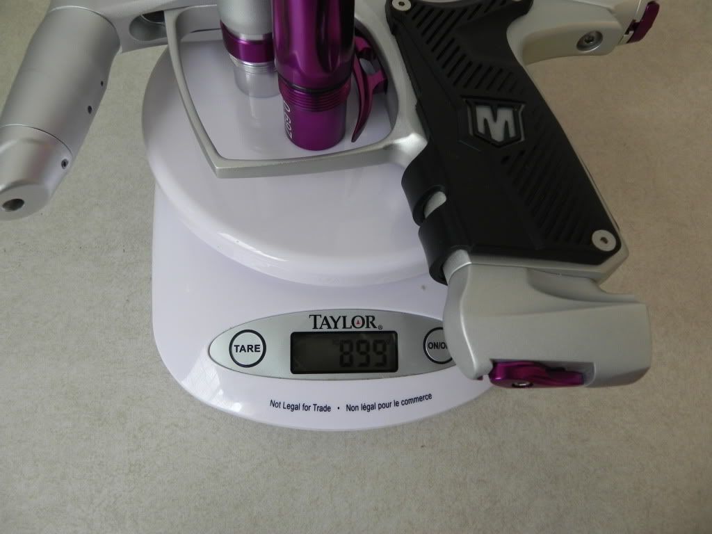

Hey I've looked and can't seem to find an answer , people say this gun is really light, how much does it actually weigh?

Hmm... I can't remember the exact amount, but a user on here took pictures of his luxe weight compared to the vapor and it was around 2.2 oz lighter.

Just so everyone knows...899 grams = 1.98195574 pounds (directly from Mr. Google)
