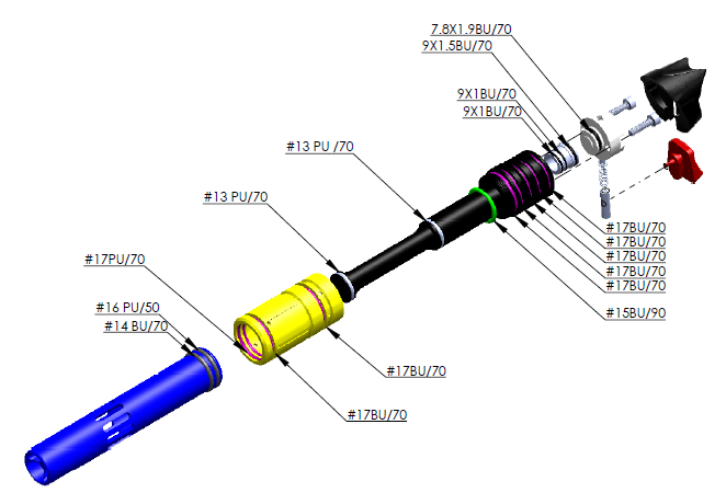

Anyone notice that in the manual the the rear o-ring on the bolt is a 016 50 shore urethane? Where are people getting these orings or what are people using in place of them? Also the stock one on mine is black, is it actually urethane?
How about the 017 purple inner can oring, is that actually urethane as well?
What are people using for the 017 front and rear breach orings, urethane, buna, HBNR?
The 013 bolt guide orings appeared to be buna stock but since then machine paintball sent some translucent urethanes orings.
Pooty sent what appeared to buna 013 bolt guide orings with his pooty bolt but those did not last long. After about 6 cases the cleaned un-lubed bolt would just slide off the cleaned un-lubed bolt guide while testing the oring fitment.
Check my tuning guide. I use 70 durometer orings for everything except the bumpers.
sail is 016/70
can, breech, and the four valve housing orings are all 017/70
bolt guide should be some size that's slightly larger that 013, but you can get away with 013/70.
I don't really see a reason to start mixing and matching materials when I have a formula that already works perfectly
