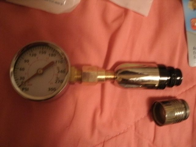

Welp, I just made my pressure tester this afternoon, and I gotta say, its not as sleek as I had hoped, but for $7, I'm happy to have it lol
I had to buy a gauge, and GOOD thing I brought the reg with me, because it turns out, marco fittings are 1/8 NPT threaded and the only gauge I could find at home depot was 1/4 NPT anyway, I just took the reg part of the CP shorty out, screwed the bottom third to the top third to keep the tester short, and because when I came up with the idea, I didn't have the thread converters in mind anyway, I get my zodiac tomorrow!!!!

Originally Posted by Bushwood Bill View Post
Wow! What pressure was your tank set at when you were at the field? And what screw stripped, the set screw?
It was an old school Ninja adjustable reg with no shims, which according to the Ninja employee I spoke to, would be around 500 psi, but I added a shim to get it around 650 when I got home.
And yeah, its the set screw for the LPR, nothing MAJOR, just a real pain on my first time using the marker, but hopefully it comes out no problem, and the screw shop down the street (they litterally make and sell screws and that's it, it was a life saver for my timmy ) has the screw since its pretty small, but hopefully the severe underpressure/drop off (my best description for it) will be solved by upping the LPR since the HPR pressure was no problem.
Oddly enough, when I got home, even with a full tank, the gun worked fine, no drop off, no balls barely making it out of the barrel, no triple or even quadruple feeds, nothing... IDK what to think at this point, its like it knows when its being watched and when there's no pressure. The only difference is I didn't use my hopper, but yesterday, I was using it with no problems. Its like it has a temper.
Also, what kind of battery does this marker take? I bought a standard 9v and it was way too short. Even though my battery doesn't need replacing badly, IDK how new it is, so I want to at least have a spare lol.
Originally Posted by p8ntballr68059 View Post
thank you for the fast response i will probably do that .. what size of gauge do i need for this can i get away with say a standard gauge i would put on my shocker reg
The gauge you have is 1/8 NPT, any female threading that accepts a macro fitting is 1/8, so if you get a QD adapter it will fit your gauge. Your gauge needs to be able to read a bit more than 200 PSI, since that is the operating pressure for the marker.

ok so if i do that tester my next question is going to be where do i attach it at or screw it into
As for Ninja tank pressure never trust what they say about shims and pressures. Always check tank pressure by using a asa on/off with a guage to check output pressure. Even with my Ninja pro regs all are different even if they have same amount of shims so always double check.
The guns are not tempermental they just need a certain tank pressure from 450-600, hpr to 200psi and your good to go. The only other thing is lube. If your using the supplied Hater V2 or somthing else like monkey poo use a light coating.
As for batteries I use Energizers I buy in bulk from Sams Club.
Just unscrew the front forgrip (with NO air) and screw in tester. Air up and set to 200psi (new 1.5 bolt) 220 (old bolt).
